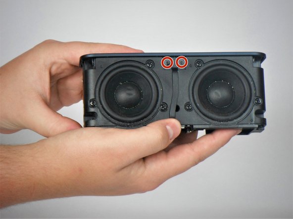

  5. Samsung Level Box Mini Speakers Replacement: crwdns2935265:05crwdnd2935265:01crwdnd2935265:01crwdne2935265:0
    • Remove the six 2.5 mm Philips #2 screws on the front of the device surrounding the speakers using the Screwdriver PH2 Philips Head.
  6. Samsung Level Box Mini Speakers Replacement: crwdns2935265:06crwdnd2935265:01crwdnd2935265:03crwdne2935265:0 Samsung Level Box Mini Speakers Replacement: crwdns2935265:06crwdnd2935265:02crwdnd2935265:03crwdne2935265:0 Samsung Level Box Mini Speakers Replacement: crwdns2935265:06crwdnd2935265:03crwdnd2935265:03crwdne2935265:0
    • Remove the eight 1.6 mm Philips #1 screws from the sides, front, and back of the device using the Screwdriver J000 Philips Head.
  7. Samsung Level Box Mini Speakers Replacement: crwdns2935265:07crwdnd2935265:01crwdnd2935265:02crwdne2935265:0 Samsung Level Box Mini Speakers Replacement: crwdns2935265:07crwdnd2935265:02crwdnd2935265:02crwdne2935265:0
    • Gently tap the back of the device to remove the speakers.
