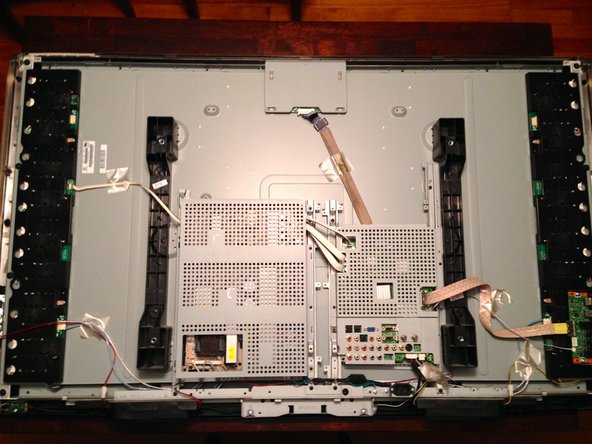

  2. Samsung LN-T5265F T-Con Board Replacement, Rear Case: crwdns2935265:03crwdnd2935265:01crwdnd2935265:02crwdne2935265:0 Samsung LN-T5265F T-Con Board Replacement, Rear Case: crwdns2935265:03crwdnd2935265:02crwdnd2935265:02crwdne2935265:0
    • Remove fifteen Phillips screws securing the rear case to the front.
    • If present, remove four Phillips screws for the VESA mount.
    • Carefully lift the rear case upwards to separate it from the frame of the TV.

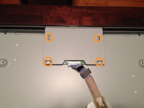

    • The Timing Controller (T-Con) board is located at the top center behind a metal shield.
    • Remove four Phillips screws.
    • Tilt the metal shield towards the top of the TV and lift away.
