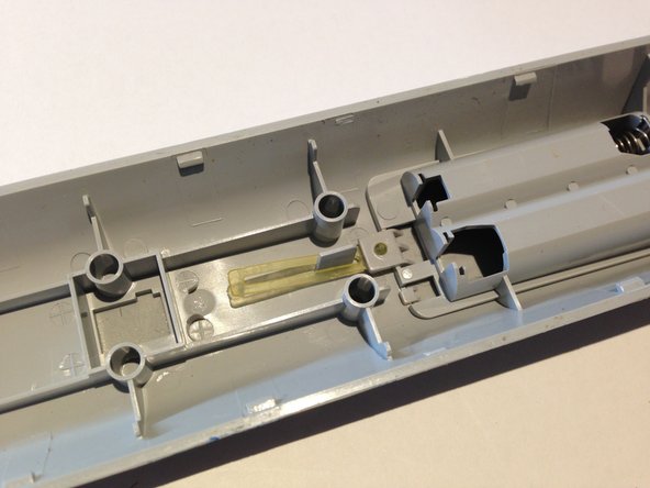

    • Remove batteries before you disassemble the remote
    • Use a case opening tool to gently split the upper and lower case
    • Work around the entire case until the 2 halves come apart completely
  2. Samsung LA40R81BD 40in LCD TV Remote Control Disassembly: crwdns2935265:02crwdnd2935265:01crwdnd2935265:02crwdne2935265:0 Samsung LA40R81BD 40in LCD TV Remote Control Disassembly: crwdns2935265:02crwdnd2935265:02crwdnd2935265:02crwdne2935265:0
    • Release the circuit board by gently pushing the plastic tab away from the board
    • Use minimal force to avoid breaking it
    • Lift circuit board off top cover to expose the rubber button membrane
    • Lift off the rubber button membrane
  3. Samsung LA40R81BD 40in LCD TV Remote Control Disassembly: crwdns2935265:03crwdnd2935265:01crwdnd2935265:02crwdne2935265:0 Samsung LA40R81BD 40in LCD TV Remote Control Disassembly: crwdns2935265:03crwdnd2935265:02crwdnd2935265:02crwdne2935265:0
    • During reassembly make sure that you correctly place the battery cover retainer on the read case
  4. Samsung LA40R81BD 40in LCD TV Remote Control Disassembly: crwdns2935265:04crwdnd2935265:01crwdnd2935265:02crwdne2935265:0 Samsung LA40R81BD 40in LCD TV Remote Control Disassembly: crwdns2935265:04crwdnd2935265:02crwdnd2935265:02crwdne2935265:0
    • When placing rear cover back onto the assembled top cover make sure you correctly align the battery terminals with the slots in the cover
