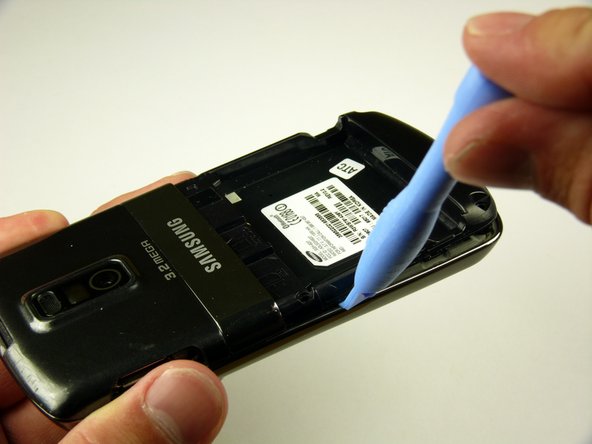

  4. Samsung Jack LCD Replacement: crwdns2935265:04crwdnd2935265:01crwdnd2935265:03crwdne2935265:0 Samsung Jack LCD Replacement: crwdns2935265:04crwdnd2935265:02crwdnd2935265:03crwdne2935265:0 Samsung Jack LCD Replacement: crwdns2935265:04crwdnd2935265:03crwdnd2935265:03crwdne2935265:0
    • The rear case is firmly attached to the phone with clips. Do not be afraid to use a little extra force.
    • Insert the Plastic Opening Tool in between the front and rear cases.
    • Pry with the Plastic Opening Tool around all edges of the phone until you free all the clips.

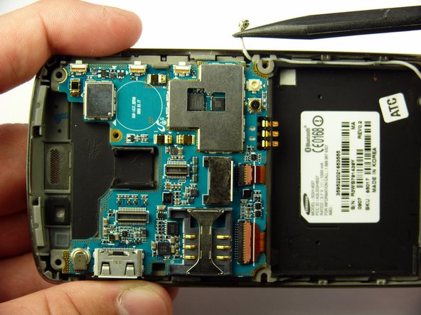

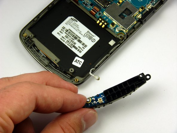

  6. Samsung Jack LCD Replacement, Antenna: crwdns2935265:06crwdnd2935265:01crwdnd2935265:01crwdne2935265:0
    • Remove the two silver 4.30 mm screws on either side of the antenna using a Phillip's #00 Screwdriver.
  7. Samsung Jack LCD Replacement: crwdns2935265:07crwdnd2935265:01crwdnd2935265:03crwdne2935265:0 Samsung Jack LCD Replacement: crwdns2935265:07crwdnd2935265:02crwdnd2935265:03crwdne2935265:0 Samsung Jack LCD Replacement: crwdns2935265:07crwdnd2935265:03crwdnd2935265:03crwdne2935265:0
    • There is a wire under the antenna connecting it to the Motherboard. Do not pull off the antenna just yet.
    • Use a spudger to remove the wire connector under the antenna.

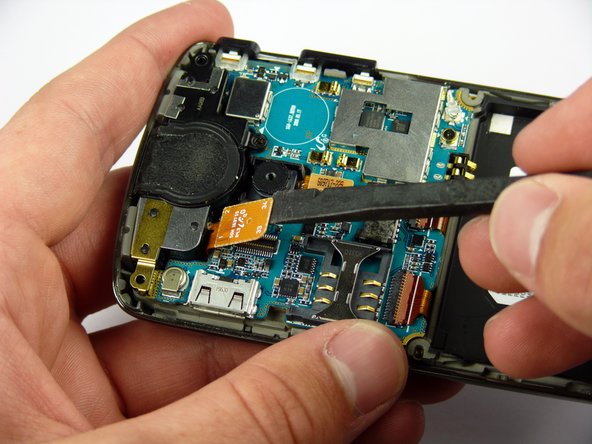

  9. Samsung Jack LCD Replacement: crwdns2935265:09crwdnd2935265:01crwdnd2935265:02crwdne2935265:0 Samsung Jack LCD Replacement: crwdns2935265:09crwdnd2935265:02crwdnd2935265:02crwdne2935265:0
    • Use the spudger to detach the speaker ribbon cable.

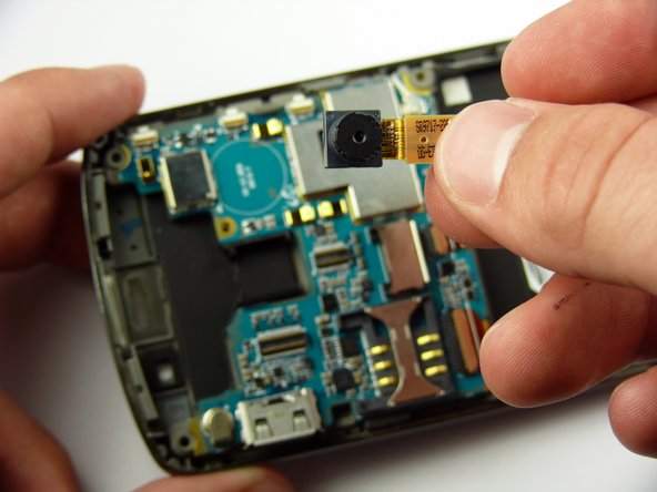

  12. Samsung Jack LCD Replacement: crwdns2935265:012crwdnd2935265:01crwdnd2935265:02crwdne2935265:0 Samsung Jack LCD Replacement: crwdns2935265:012crwdnd2935265:02crwdnd2935265:02crwdne2935265:0
    • Use a spudger to detach the camera ribbon cable.
    • Lift the camera off of the Motherboard.

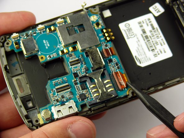

    • Use a Plastic Opening Tool to lift the flaps of the ZIF connectors to release the ribbon cables near the bottom of the Motherboard.
    • Use a spudger to carefully pull the ribbon cables away from the ZIF connectors.

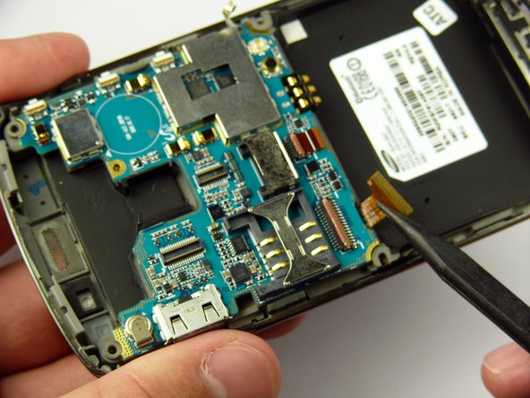

    • There is a ribbon cable under the Motherboard connecting it to the LCD. Do not pull off the Motherboard just yet.
    • Insert the Plastic Opening Tool under the upper left corner of the Motherboard to help reveal the ribbon cable.
    • Use a spudger to disconnect the Motherboard ribbon cable.

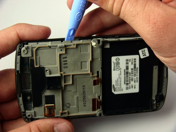

  16. Samsung Jack LCD Replacement: crwdns2935265:016crwdnd2935265:01crwdnd2935265:01crwdne2935265:0
    • Lift the Motherboard off of the phone.

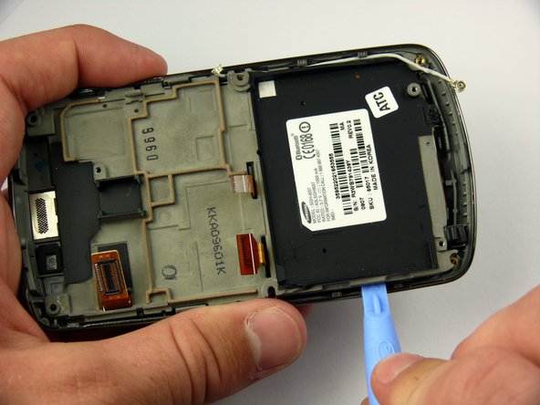

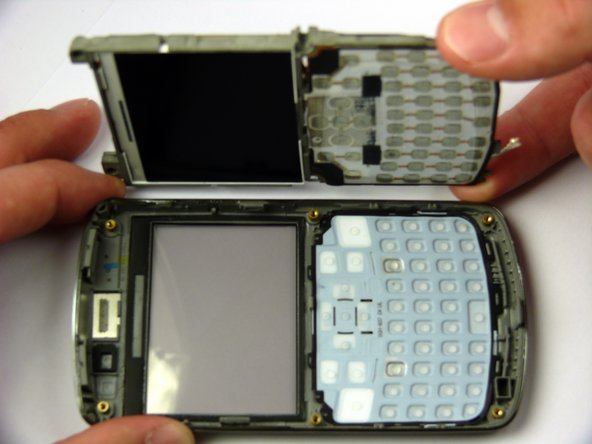

  17. Samsung Jack LCD Replacement, LCD: crwdns2935265:017crwdnd2935265:01crwdnd2935265:03crwdne2935265:0 Samsung Jack LCD Replacement, LCD: crwdns2935265:017crwdnd2935265:02crwdnd2935265:03crwdne2935265:0 Samsung Jack LCD Replacement, LCD: crwdns2935265:017crwdnd2935265:03crwdnd2935265:03crwdne2935265:0
    • The LCD frame is firmly attached to the phone with clips. Do not be afraid to use a little extra force.
    • Insert the Plastic Opening Tool between the LCD frame and the front case of the phone.
    • Slide the Plastic Opening Tool around the LCD frame to detach all of the clips.
  18. Samsung Jack LCD Replacement: crwdns2935265:018crwdnd2935265:01crwdnd2935265:02crwdne2935265:0 Samsung Jack LCD Replacement: crwdns2935265:018crwdnd2935265:02crwdnd2935265:02crwdne2935265:0
    • Lift up the LCD frame.

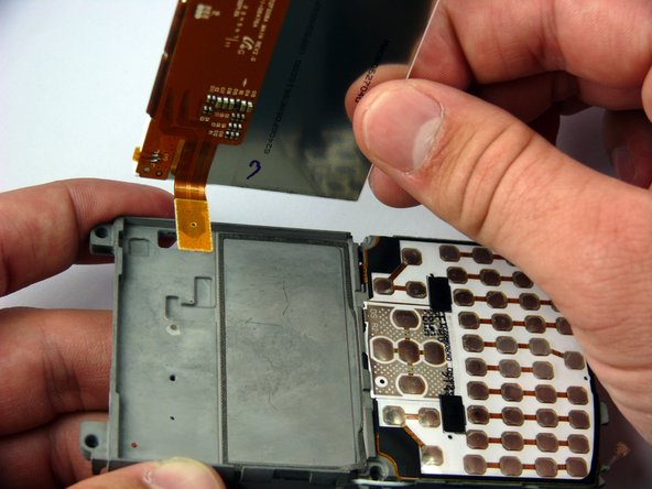

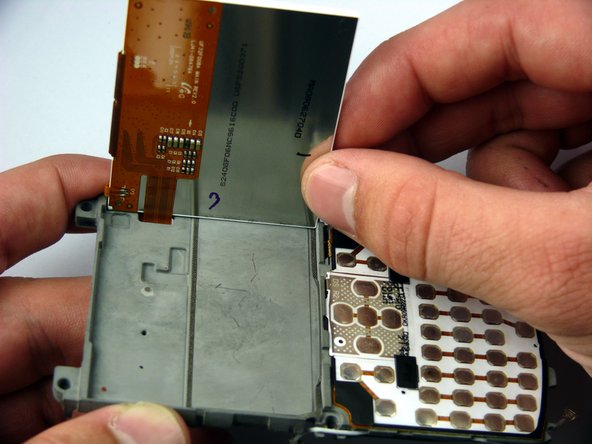

  19. Samsung Jack LCD Replacement: crwdns2935265:019crwdnd2935265:01crwdnd2935265:03crwdne2935265:0 Samsung Jack LCD Replacement: crwdns2935265:019crwdnd2935265:02crwdnd2935265:03crwdne2935265:0 Samsung Jack LCD Replacement: crwdns2935265:019crwdnd2935265:03crwdnd2935265:03crwdne2935265:0
    • There is a hanging ribbon cable connected to the LCD screen that passes through the LCD frame.
    • Insert the spudger under the bottom left corner of the LCD screen.
    • Use the spudger to gently pry the LCD screen out of its frame.
    • Gently remove the screen from the frame.
