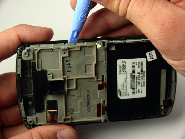

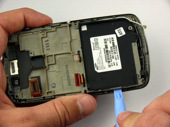

    • The rear case is firmly attached to the phone with clips. Do not be afraid to use a little extra force.
    • Insert the Plastic Opening Tool in between the front and rear cases.
    • Pry with the Plastic Opening Tool around all edges of the phone until you free all the clips.
  5. Samsung Jack Keyboard Replacement: crwdns2935265:05crwdnd2935265:01crwdnd2935265:01crwdne2935265:0
    • Lift the rear case off of the phone.

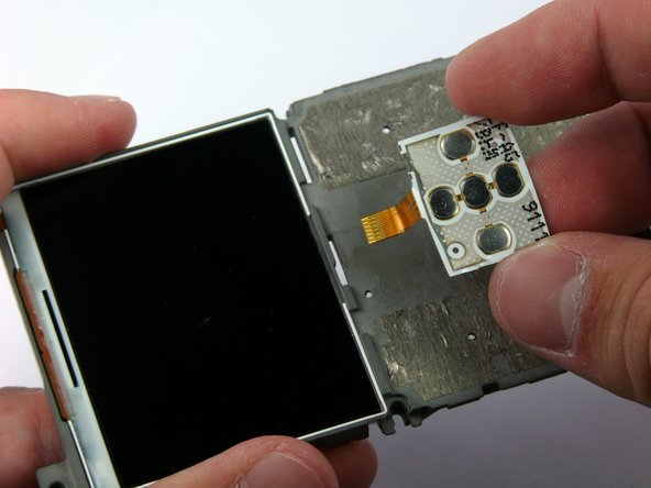

  17. Samsung Jack Keyboard Replacement, Keyboard: crwdns2935265:017crwdnd2935265:01crwdnd2935265:03crwdne2935265:0 Samsung Jack Keyboard Replacement, Keyboard: crwdns2935265:017crwdnd2935265:02crwdnd2935265:03crwdne2935265:0 Samsung Jack Keyboard Replacement, Keyboard: crwdns2935265:017crwdnd2935265:03crwdnd2935265:03crwdne2935265:0

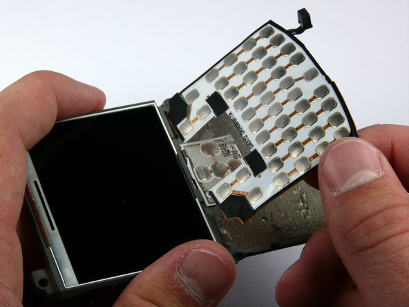

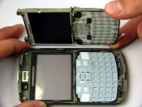

    • The LCD frame is firmly attached to the phone with clips. Do not be afraid to use a little extra force.
    • Insert the Plastic Opening Tool between the LCD frame and the front case of the phone.
    • Slide the Plastic Opening Tool around the LCD frame to detach all of the clips.
  18. Samsung Jack Keyboard Replacement: crwdns2935265:018crwdnd2935265:01crwdnd2935265:02crwdne2935265:0 Samsung Jack Keyboard Replacement: crwdns2935265:018crwdnd2935265:02crwdnd2935265:02crwdne2935265:0
    • Lift up the LCD frame.
  19. Samsung Jack Keyboard Replacement: crwdns2935265:019crwdnd2935265:01crwdnd2935265:03crwdne2935265:0 Samsung Jack Keyboard Replacement: crwdns2935265:019crwdnd2935265:02crwdnd2935265:03crwdne2935265:0 Samsung Jack Keyboard Replacement: crwdns2935265:019crwdnd2935265:03crwdnd2935265:03crwdne2935265:0

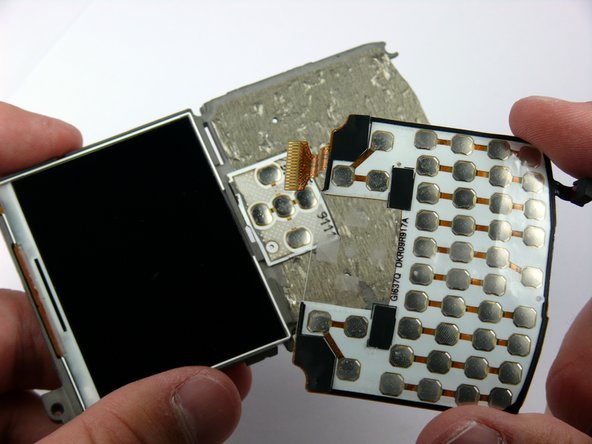

    • The keyboard ribbon cable passes through the LCD frame. Be careful not to rip the ribbon cable when removing the keyboard.
    • The keyboard and directional keys are glued separately to the LCD frame.
    • Insert the spudger between the keyboard and the frame.
    • Peel the keyboard off by sliding the spudger back and forth across the LCD frame.
  20. Samsung Jack Keyboard Replacement: crwdns2935265:020crwdnd2935265:01crwdnd2935265:03crwdne2935265:0 Samsung Jack Keyboard Replacement: crwdns2935265:020crwdnd2935265:02crwdnd2935265:03crwdne2935265:0 Samsung Jack Keyboard Replacement: crwdns2935265:020crwdnd2935265:03crwdnd2935265:03crwdne2935265:0

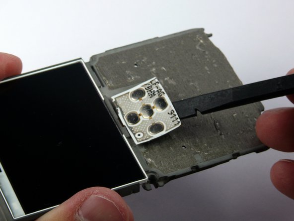

    • Insert the spudger between the directional keys and the frame.
    • Peel the directional keys off by sliding the spudger back and forth across the LCD frame.
