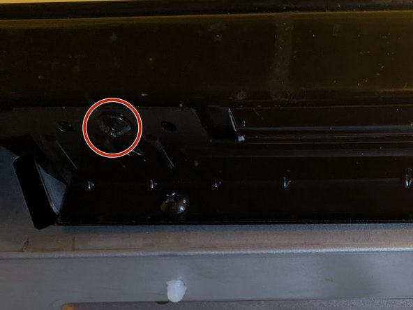

  2. Samsung Induction Cooktop NE63B8211SS Right Power Inverter Replacement, Remove Front Screws: crwdns2935265:02crwdnd2935265:01crwdnd2935265:02crwdne2935265:0 Samsung Induction Cooktop NE63B8211SS Right Power Inverter Replacement, Remove Front Screws: crwdns2935265:02crwdnd2935265:02crwdnd2935265:02crwdne2935265:0

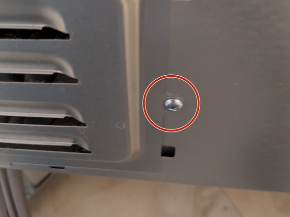

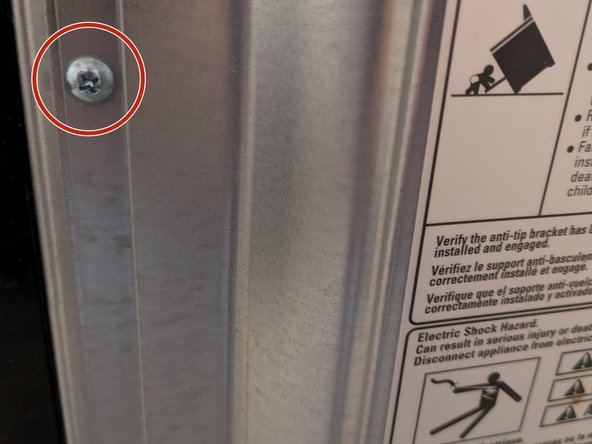

    • Open the oven door. There are three screws you need to remove from the front side in order to lift the cooktop

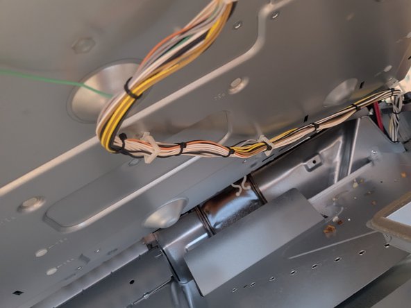

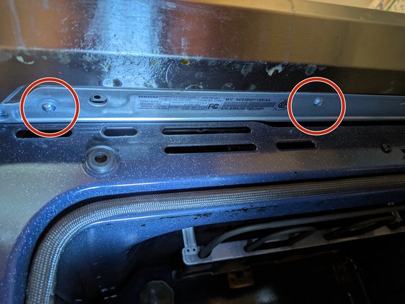

  3. Samsung Induction Cooktop NE63B8211SS Right Power Inverter Replacement, Remove the backing and back screws: crwdns2935265:03crwdnd2935265:01crwdnd2935265:03crwdne2935265:0 Samsung Induction Cooktop NE63B8211SS Right Power Inverter Replacement, Remove the backing and back screws: crwdns2935265:03crwdnd2935265:02crwdnd2935265:03crwdne2935265:0 Samsung Induction Cooktop NE63B8211SS Right Power Inverter Replacement, Remove the backing and back screws: crwdns2935265:03crwdnd2935265:03crwdnd2935265:03crwdne2935265:0
    • To lift the cooktop, a few screws need to be removed from the back. While doing this, also remove the backing, as it will expose harnesses that need to be unplugged for a later step.
    • To entirely remove the backing, there are 3 screws. Two attached to the frame along the side and one attached to the vent. After these are removed, the backing simply needs to be lifted out of place.

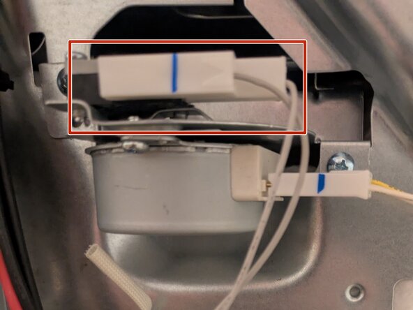

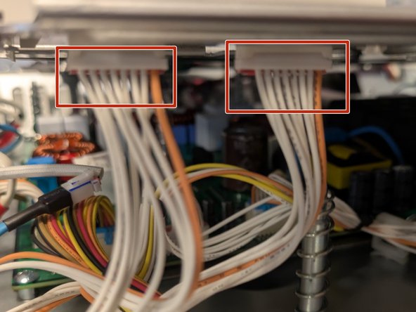

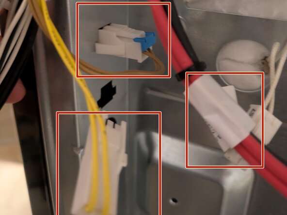

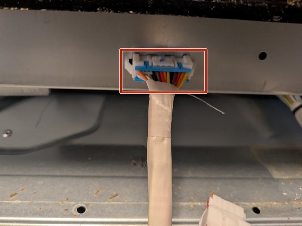

  4. Samsung Induction Cooktop NE63B8211SS Right Power Inverter Replacement, Detach Back Wiring: crwdns2935265:04crwdnd2935265:01crwdnd2935265:03crwdne2935265:0 Samsung Induction Cooktop NE63B8211SS Right Power Inverter Replacement, Detach Back Wiring: crwdns2935265:04crwdnd2935265:02crwdnd2935265:03crwdne2935265:0 Samsung Induction Cooktop NE63B8211SS Right Power Inverter Replacement, Detach Back Wiring: crwdns2935265:04crwdnd2935265:03crwdnd2935265:03crwdne2935265:0
    • The assay also has wires that run to the back of the oven. These should be disconnected.
    • Note that there is one a plug that isn't attached to anything, this will remain that way.

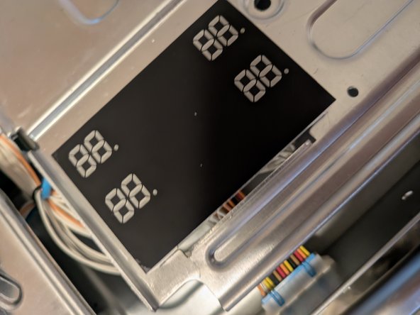

    • To get the cooktop isolated, the control panel needs to be detached and have its harnesses disconnected.
    • Harnesses connected to a PCB in the back and a control panel in the front are still attached. You will want to gently lift the cooktop until the screws on the left and right are exposed.
  6. Samsung Induction Cooktop NE63B8211SS Right Power Inverter Replacement, Detach Harnesses: crwdns2935265:06crwdnd2935265:01crwdnd2935265:02crwdne2935265:0 Samsung Induction Cooktop NE63B8211SS Right Power Inverter Replacement, Detach Harnesses: crwdns2935265:06crwdnd2935265:02crwdnd2935265:02crwdne2935265:0
    • The control panel has four harnesses that need to be disconnected from the cooktop.
    • 1 harness goes from the panel to the cooktop, the other 4 come harnesses lead to the back of the stove.

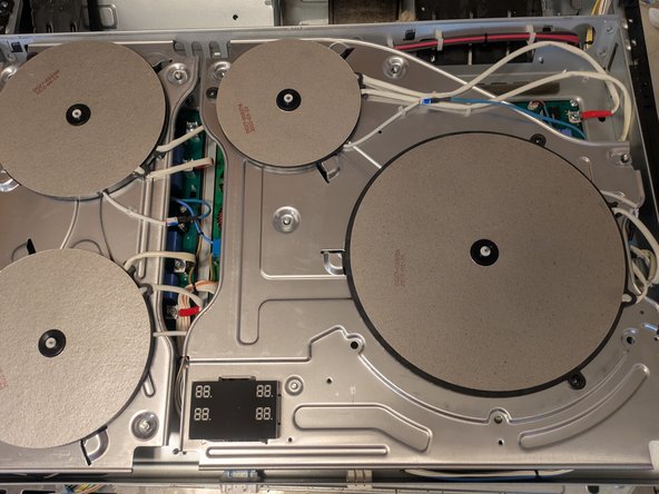

  8. Samsung Induction Cooktop NE63B8211SS Right Power Inverter Replacement, Disconnect Burners & LED  from Assay: crwdns2935265:08crwdnd2935265:01crwdnd2935265:03crwdne2935265:0 Samsung Induction Cooktop NE63B8211SS Right Power Inverter Replacement, Disconnect Burners & LED  from Assay: crwdns2935265:08crwdnd2935265:02crwdnd2935265:03crwdne2935265:0 Samsung Induction Cooktop NE63B8211SS Right Power Inverter Replacement, Disconnect Burners & LED  from Assay: crwdns2935265:08crwdnd2935265:03crwdnd2935265:03crwdne2935265:0
    • The right burners have wires that connect them to the assay. These will need to be disconnected, so the burners can be set aside and allow for proper access to the inverter.
    • The first two connections are found on top of the burners.
    • The LED panel has two harnesses to disconnect
  9. Samsung Induction Cooktop NE63B8211SS Right Power Inverter Replacement, Disconnect Burners from Intverter Terminals: crwdns2935265:09crwdnd2935265:01crwdnd2935265:01crwdne2935265:0
    • Each burner has a black and red connection connected to a terminal, disconnect these to fully disconnect the burners from the assay.

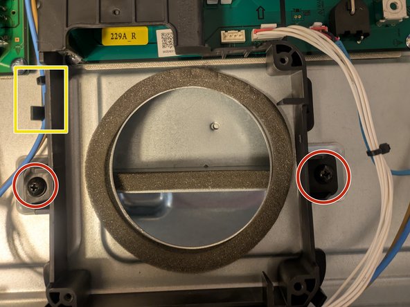

  10. Samsung Induction Cooktop NE63B8211SS Right Power Inverter Replacement, Remove Fan: crwdns2935265:010crwdnd2935265:01crwdnd2935265:02crwdne2935265:0 Samsung Induction Cooktop NE63B8211SS Right Power Inverter Replacement, Remove Fan: crwdns2935265:010crwdnd2935265:02crwdnd2935265:02crwdne2935265:0
    • The fan for the right inverter keeps the inverter locked in place. Removing this will allow you to remove the inverter.
    • The fan housing has clips to keep the wires tight to the frame. Gently remove the wires from the clips before fan removal as they are easily broken.
    • Remove the two screws and disconnect the power from the PCB. Once completed, lift the fan out of the housing.
    • Once the fan is removed, remove the screws attaching the housing to the assay. Be sure to also lift the wire out of side clip before removing the plastic housing.

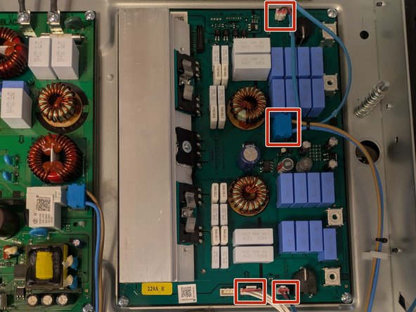

  11. Samsung Induction Cooktop NE63B8211SS Right Power Inverter Replacement, Remove the Inverter: crwdns2935265:011crwdnd2935265:01crwdnd2935265:02crwdne2935265:0 Samsung Induction Cooktop NE63B8211SS Right Power Inverter Replacement, Remove the Inverter: crwdns2935265:011crwdnd2935265:02crwdnd2935265:02crwdne2935265:0
    • At this step, you can double check that it is in fact your inverter that is bad. There may be an obvious sign, like a scorch mark on the PCB.
    • Once certain the inverter is the issue, there are four remaining harness points to unplug.
    • Once the harnesses are unplugged, remove the four screws keeping the board fixed in place.
    • There are two plastic pins that further secure the inverter. Take a pair of pliers to squeeze these down and gently lift the board off the housing.
    • Insert the new inverter and reconnect the harnesses

I got exactly this issue with my stove (not the same model) with exactly the same burned chip.
Changing the right inverter and center controller fixed the issue!
Thanks a lot for you guide!
