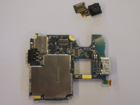

    1. Samsung Impression Camera Replacement, Camera: crwdns2935265:07crwdnd2935265:01crwdnd2935265:02crwdne2935265:0 Samsung Impression Camera Replacement, Camera: crwdns2935265:07crwdnd2935265:02crwdnd2935265:02crwdne2935265:0
      • Turn the circuit board over.
      • The bottom of the camera will have a gold ribbon coming out of it which attaches to the circuit board.
      • Pull upwards on the blue rectangle where the gold ribbon ends. This will remove the camera from the circuit board.
