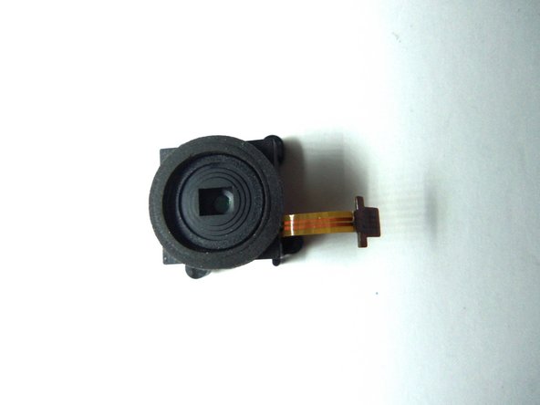

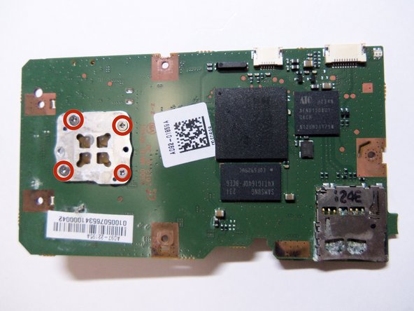

    1. Samsung HMX-W300 Lens  Replacement, Lens screws: crwdns2935265:011crwdnd2935265:01crwdnd2935265:02crwdne2935265:0 Samsung HMX-W300 Lens  Replacement, Lens screws: crwdns2935265:011crwdnd2935265:02crwdnd2935265:02crwdne2935265:0
      • Shows front of motherboard and rear of motherboard.
      • Lens has 4 Phillips size 00 screws.
    2. Samsung HMX-W300 Lens  Replacement, Remove wire ribbon: crwdns2935265:012crwdnd2935265:01crwdnd2935265:01crwdne2935265:0
      • Unplug the wire ribbon from the motherboard.
    3. Samsung HMX-W300 Lens  Replacement, Remove lens screws: crwdns2935265:013crwdnd2935265:01crwdnd2935265:02crwdne2935265:0 Samsung HMX-W300 Lens  Replacement, Remove lens screws: crwdns2935265:013crwdnd2935265:02crwdnd2935265:02crwdne2935265:0
      • Remove all 4 PH(00) screws, this will loosen the lens from the motherboard.
