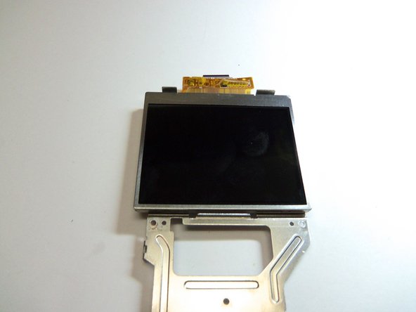

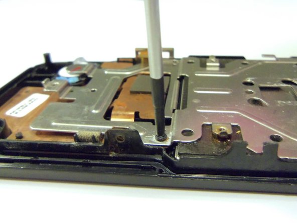

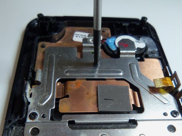

    1. Samsung HMX-W300 LCD Screen Replacement, Remove screws.: crwdns2935265:011crwdnd2935265:01crwdnd2935265:03crwdne2935265:0 Samsung HMX-W300 LCD Screen Replacement, Remove screws.: crwdns2935265:011crwdnd2935265:02crwdnd2935265:03crwdne2935265:0 Samsung HMX-W300 LCD Screen Replacement, Remove screws.: crwdns2935265:011crwdnd2935265:03crwdnd2935265:03crwdne2935265:0
      • Use Phillips size 00 and remove the 3 screws as shown.

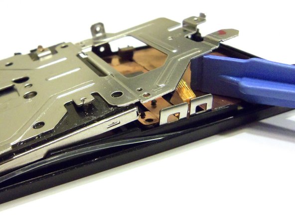

    2. Samsung HMX-W300 LCD Screen Replacement, Pry screen.: crwdns2935265:012crwdnd2935265:01crwdnd2935265:02crwdne2935265:0 Samsung HMX-W300 LCD Screen Replacement, Pry screen.: crwdns2935265:012crwdnd2935265:02crwdnd2935265:02crwdne2935265:0
      • Pry the end of the screen with the plastic opening tool.

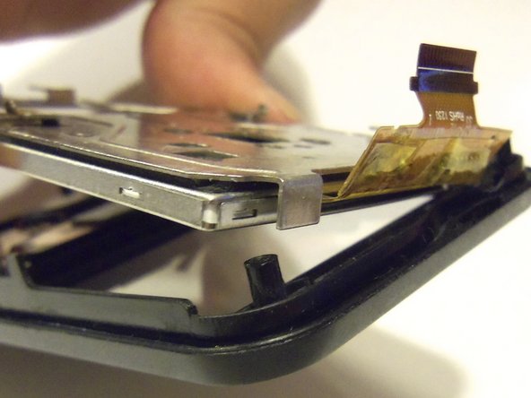

    3. Samsung HMX-W300 LCD Screen Replacement: crwdns2935265:013crwdnd2935265:01crwdnd2935265:03crwdne2935265:0 Samsung HMX-W300 LCD Screen Replacement: crwdns2935265:013crwdnd2935265:02crwdnd2935265:03crwdne2935265:0 Samsung HMX-W300 LCD Screen Replacement: crwdns2935265:013crwdnd2935265:03crwdnd2935265:03crwdne2935265:0
      • Grab the end of the screen, then pull towards the inside of the case. This is a bit tricky. This will release tabs at the top of the screen to the rear case.
