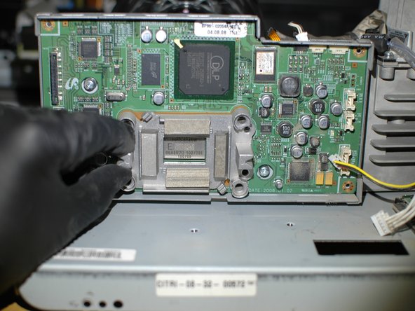

    • Here is a prime example of a failed DLP chip. The TV has become basically impossible to use due to the overwhelming number of stuck mirrors in the DLP chip. Let's fix it!

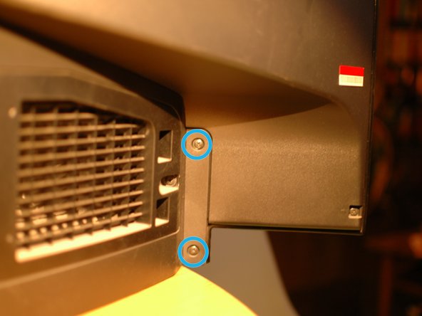

    • You will then find two more screws on the far left of the TV, just to the left of the A/V inputs.
    • And finally there are two more black Phillips screws on the far right, past the air intake for the bulb vent.
    • With all ten screws removed the rear cover can be pulled off. Note that there is a long vent snorkel on the far right side for the bulb that will have to clear the frame of the TV.

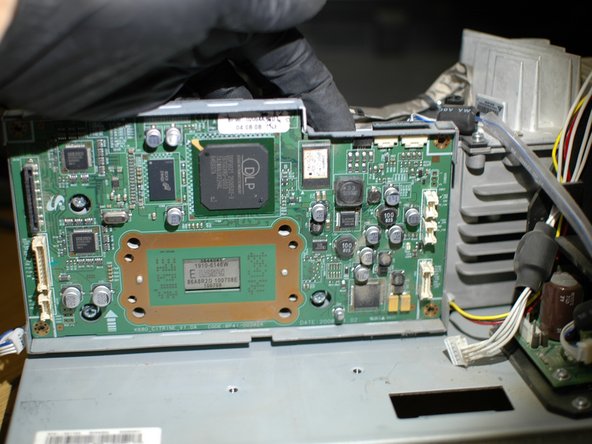

    • With the rear cover removed you will see the body of the "light engine" which contains the bulb, color wheel, lens, DMD board (with the DLP chip) among other components.

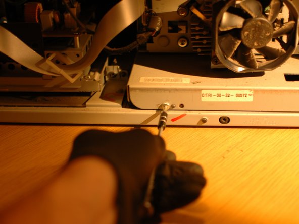

    • To proceed you will need to remove the light engine. To do this, remove the two silver Phillips screws that hold the light engine rack to the frame of the TV.

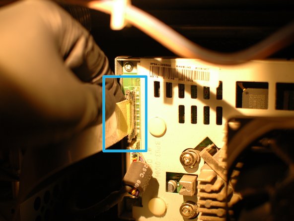

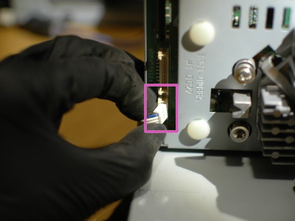

    • Next you will remove the upper two cables on the left hand side of the light engine, which plug in to the DMD board.
    • First, remove the upper silver ribbon cable. Press in on the top and bottom of cable end to release the small clips that hold it in the plug.
    • Then remove the second cable by pressing on the clip that holds the white cable end in to the plug and pulling it straight out at the same time.

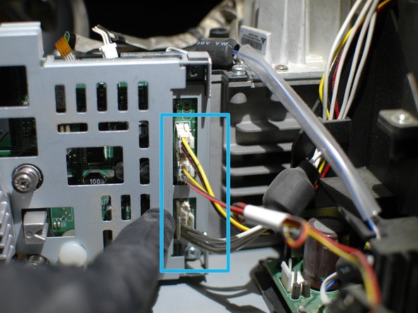

  7. Samsung HL56A650C1FXZA 56-inch DLP TV DLP Chip Replacement: crwdns2935265:07crwdnd2935265:01crwdnd2935265:02crwdne2935265:0 Samsung HL56A650C1FXZA 56-inch DLP TV DLP Chip Replacement: crwdns2935265:07crwdnd2935265:02crwdnd2935265:02crwdne2935265:0

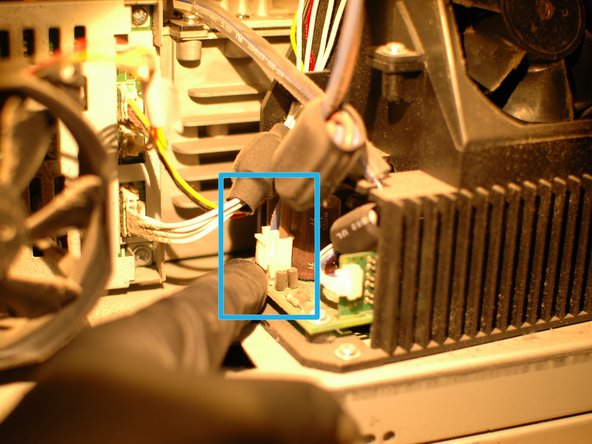

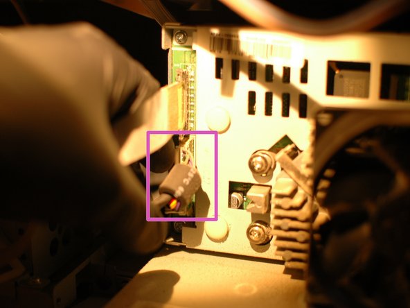

    • Next you will remove the power cable that runs to the board next to the DMD board, underneath the fan for the light bulb.
    • Remove the cable end by pressing on the white clip that holds the end in to the plug while pulling up on the cable.
  8. Samsung HL56A650C1FXZA 56-inch DLP TV DLP Chip Replacement: crwdns2935265:08crwdnd2935265:01crwdnd2935265:01crwdne2935265:0
    • While not completely necessary, it can help to remove this power cable from the cable ties that hold it to the top of the TV frame. This will get it out of the way when you remove and install the light engine.

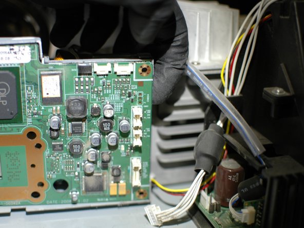

  11. Samsung HL56A650C1FXZA 56-inch DLP TV DLP Chip Replacement: crwdns2935265:011crwdnd2935265:01crwdnd2935265:03crwdne2935265:0 Samsung HL56A650C1FXZA 56-inch DLP TV DLP Chip Replacement: crwdns2935265:011crwdnd2935265:02crwdnd2935265:03crwdne2935265:0 Samsung HL56A650C1FXZA 56-inch DLP TV DLP Chip Replacement: crwdns2935265:011crwdnd2935265:03crwdnd2935265:03crwdne2935265:0
    • Next, proceed by removing all of the cables that connect to the DMD board.
    • At the upper right edge there is a small ribbon cable that pulls straight up to remove, and two other cables that connect with cable ends that clip in to the small plugs. Remove these three cables carefully.
    • Next, remove the three cables on the right end of the DMD board. The two upper are fan power cables, and the lower connects to the light bulb controls.
    • Finally, remove the lower most cable that connects to the bottom left corner of the DMD board.

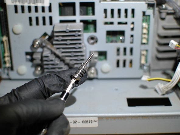

    • Remove the four spring-loaded screws that reside on each side of the heatsink. These screws apply pressure to the DMD board to hold it in position, under tension - once adjusted at the factory the the DMD board needs to be held in place over the long term or the picture quality will suffer.
    • See the springs that sit behind the screws in the second picture.

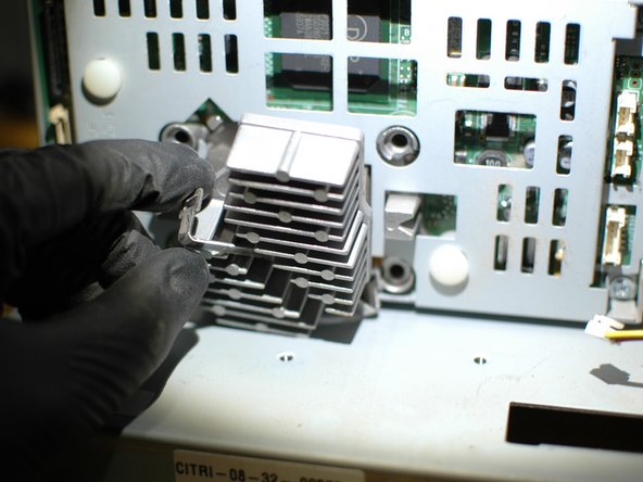

  14. Samsung HL56A650C1FXZA 56-inch DLP TV DLP Chip Replacement: crwdns2935265:014crwdnd2935265:01crwdnd2935265:02crwdne2935265:0 Samsung HL56A650C1FXZA 56-inch DLP TV DLP Chip Replacement: crwdns2935265:014crwdnd2935265:02crwdnd2935265:02crwdne2935265:0
    • Next use a pliers to remove the clip that holds the DLP chip heatsink in place.
    • You may find that the heatsink falls off as you remove the clip. If not, a gentle pull should remove it.

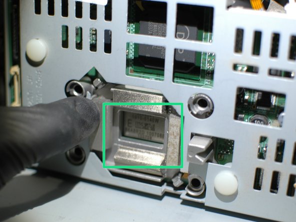

  15. Samsung HL56A650C1FXZA 56-inch DLP TV DLP Chip Replacement: crwdns2935265:015crwdnd2935265:01crwdnd2935265:02crwdne2935265:0 Samsung HL56A650C1FXZA 56-inch DLP TV DLP Chip Replacement: crwdns2935265:015crwdnd2935265:02crwdnd2935265:02crwdne2935265:0
    • With the heatsink removed you will see the thermal pad that was installed at the factory.
    • If you plan to reuse this thermal pad with the new DLP chip be sure to keep it protected while you complete this guide.
    • There is some suggestion that inadequate thermal paste leads to the premature failure of the DLP chips on these TV's, so you may also consider removing the factory thermal pad and putting a better thermal paste like Arctic Silver on the chip itself, like you would with a computer processor.
    • If you decide to do this, at this time you can follow the manufacturer's instructions for cleaning the heatsink of the old thermal paste and, if applicable, tinting the heatsink.
    • Looking through the hole where the heatsink sits you can see the top of the DLP chip. Almost there!

    • With the DMD board exposed, proceed to remove the four screws that hold the heatsink bracket to the board.
    • DO NOT touch the screws highlighted in red.
    • These three screws highlighted in red are for adjustment of the DLP chip/DMD board. If you touch them you will throw off the factory adjustment of your chip.
    • With the four screws highlighted in green removed you can remove the heatsink bracket.

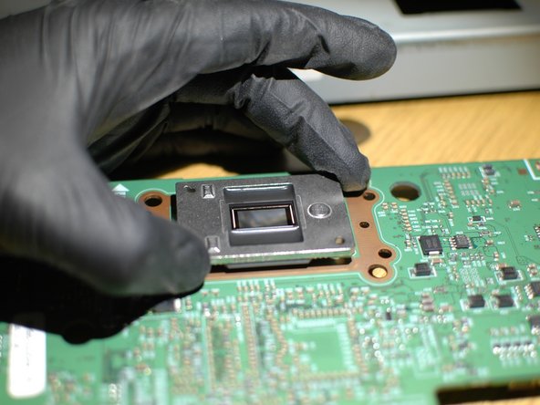

  21. Samsung HL56A650C1FXZA 56-inch DLP TV DLP Chip Replacement: crwdns2935265:021crwdnd2935265:01crwdnd2935265:02crwdne2935265:0 Samsung HL56A650C1FXZA 56-inch DLP TV DLP Chip Replacement: crwdns2935265:021crwdnd2935265:02crwdnd2935265:02crwdne2935265:0
    • Turn the DMD board over and you will see the DLP chip.
    • If you've ever removed a computer CPU you will find this is a bit different. The chip is not held in with a "Zero Insertion Force" mechanism with a clip or lever. Instead, it is held in by the tension of the pins alone.
    • Therefore, when removing the chip, simply pull up until it releases from the board.
  22. Samsung HL56A650C1FXZA 56-inch DLP TV DLP Chip Replacement: crwdns2935265:022crwdnd2935265:01crwdnd2935265:03crwdne2935265:0 Samsung HL56A650C1FXZA 56-inch DLP TV DLP Chip Replacement: crwdns2935265:022crwdnd2935265:02crwdnd2935265:03crwdne2935265:0 Samsung HL56A650C1FXZA 56-inch DLP TV DLP Chip Replacement: crwdns2935265:022crwdnd2935265:03crwdnd2935265:03crwdne2935265:0
    • In the first picture, see the outside facing part of the chip that touches the heatsink. From the factory the top of the chip doesn't have any thermal compound on it. This is where I chose to add Arctic Silver thermal paste to help with the thermal protection of the chip. This is optional.
    • In the second picture you can see the defective mirror surface in the DLP chip. A good mirror surface should look clean with a rainbow effect. This defective mirror shows many small spots.
    • In the third picture you can see the socket that the DLP chip fits in to. When installing your replacement chip it simply pushes in.
    • Be very careful not to touch the mirror surface of the chip. Also, if you see ANY dust on the mirror surface of the chip, remove it with canned air and/or a soft lint free cloth until it's perfectly clean.
