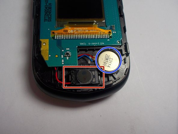

    • Flip open the phone as shown in picture 1.
    • Remove the two screws highlighted in picture 1.
  2. Samsung Gusto 2 Speaker Replacement: crwdns2935265:02crwdnd2935265:01crwdnd2935265:01crwdne2935265:0
    • Take your spudger and forcefully insert it between the black and silver part of the phone.
    • Once the spudger is successfully wedged in between these two pieces, circle the frame of the phone.
  3. Samsung Gusto 2 Speaker Replacement: crwdns2935265:03crwdnd2935265:01crwdnd2935265:02crwdne2935265:0 Samsung Gusto 2 Speaker Replacement: crwdns2935265:03crwdnd2935265:02crwdnd2935265:02crwdne2935265:0
    • The phone should be exposed like picture 1 once the case was removed.
    • The highlighted sections correspond to the bullet colors. To replace either simply disconnect the wires attached, and lift the piece off.
    • Speaker Component
    • Vibration Component
