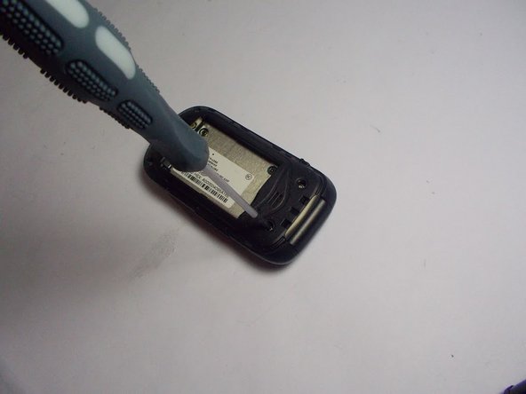

    • Remove the four screws shown using a small screwdriver.

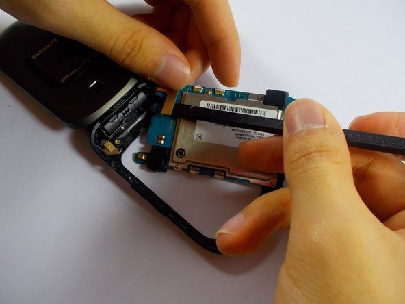

    • Using the prying tool,lift the orange flap that is keeping the motherboard in place.
    • Remove the motherboard from the phone.

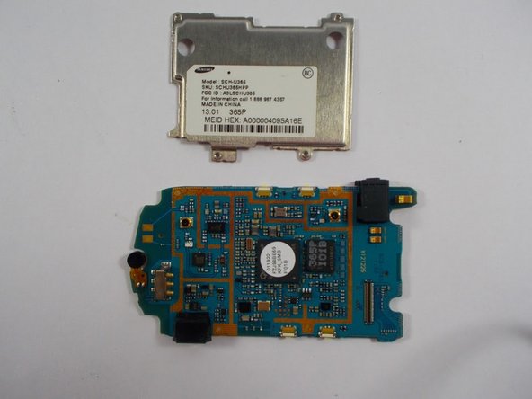

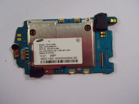

    • Remove the four screws using a small screwdriver.
    • Remove the metal protective case to reveal the motherboard.
