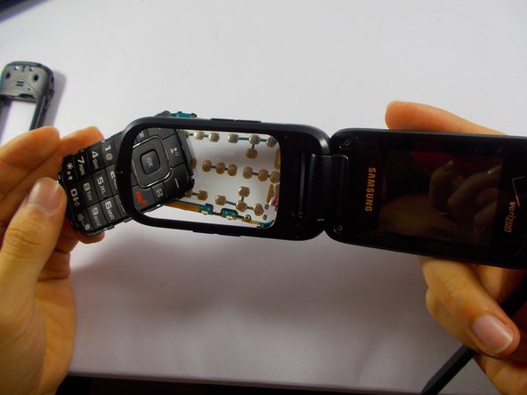

  6. Samsung Gusto 2 Keypad Replacement: crwdns2935265:06crwdnd2935265:01crwdnd2935265:03crwdne2935265:0 Samsung Gusto 2 Keypad Replacement: crwdns2935265:06crwdnd2935265:02crwdnd2935265:03crwdne2935265:0 Samsung Gusto 2 Keypad Replacement: crwdns2935265:06crwdnd2935265:03crwdnd2935265:03crwdne2935265:0
    • The back should now be exposed like the first picture after the case was removed.
    • Flip open the phone, main screen facing up.
    • Push the keypad and slide it out.
