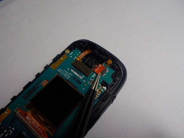

  4. Samsung Gusto 2 Camera Replacement: crwdns2935265:04crwdnd2935265:01crwdnd2935265:02crwdne2935265:0 Samsung Gusto 2 Camera Replacement: crwdns2935265:04crwdnd2935265:02crwdnd2935265:02crwdne2935265:0
    • Look at the first image to identify the location of the camera.
    • Use tweezers to remove the orange flap keeping the camera in place.
  5. Samsung Gusto 2 Camera Replacement: crwdns2935265:05crwdnd2935265:01crwdnd2935265:01crwdne2935265:0
    • Use tweezers to gently remove the camera.
