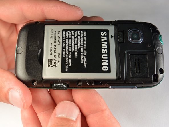

      • Pry the back cover off with a plastic opening tool, or your fingernail, in the indentation on the bottom of the device.
    2. Samsung Gravity TXT microSD Card  Replacement: crwdns2935265:02crwdnd2935265:01crwdnd2935265:01crwdne2935265:0
      • Lift the back cover away from the main body of the phone.
    3. Samsung Gravity TXT microSD Card  Replacement: crwdns2935265:03crwdnd2935265:01crwdnd2935265:01crwdne2935265:0
      • Insert your finger in the groove below the battery.
      • Press the battery toward the audio jack while lifting upward and away from the phone.
      • Remember to place the battery back with the copper contacts on the battery lined up with those on the phone.
    1. Samsung Gravity TXT microSD Card  Replacement, microSD Card: crwdns2935265:04crwdnd2935265:01crwdnd2935265:03crwdne2935265:0 Samsung Gravity TXT microSD Card  Replacement, microSD Card: crwdns2935265:04crwdnd2935265:02crwdnd2935265:03crwdne2935265:0 Samsung Gravity TXT microSD Card  Replacement, microSD Card: crwdns2935265:04crwdnd2935265:03crwdnd2935265:03crwdne2935265:0
      • Using your fingernail, push the microSD card slightly deeper into the slot, until you hear a click.
      • The removal of the battery is not required for this operation; therefore, step 3 can be skipped if just replacing the microSD card.
      • After the click, release the microSD card to allow it to pop out.
      • Remove the microSD card from its slot
      • When placing the microSD card back in the phone, make sure the card clicks in place.
