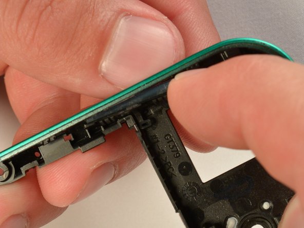

    1. Samsung Gravity TXT Volume Rocker Replacement, Volume Rocker: crwdns2935265:08crwdnd2935265:01crwdnd2935265:01crwdne2935265:0
      • Unhook the volume rocker tether with a pair of tweezers or the pointed end of a spudger.
      • The button and tether will be in the plastic back frame
    2. Samsung Gravity TXT Volume Rocker Replacement: crwdns2935265:09crwdnd2935265:01crwdnd2935265:02crwdne2935265:0 Samsung Gravity TXT Volume Rocker Replacement: crwdns2935265:09crwdnd2935265:02crwdnd2935265:02crwdne2935265:0
      • Push the + end of the volume rocker toward the inside of the back frame until it rolls over the "+ end" retainer feature on the frame.
      • You may have to use the back end of a plastic opening tool or solid object to press the + side far enough to release it.
      • New line.Lift the button out of its slot in the frame.
