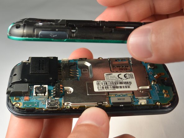

      • Pry the back cover off with a plastic opening tool, or your fingernail, in the indentation on the bottom of the device.
    2. Samsung Gravity TXT Screen Replacement: crwdns2935265:02crwdnd2935265:01crwdnd2935265:01crwdne2935265:0
      • Lift the back cover away from the main body of the phone.

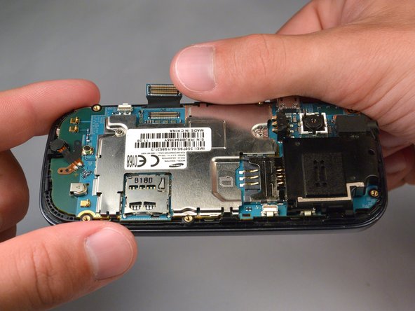

    1. Samsung Gravity TXT Screen Replacement, SIM Card: crwdns2935265:04crwdnd2935265:01crwdnd2935265:03crwdne2935265:0 Samsung Gravity TXT Screen Replacement, SIM Card: crwdns2935265:04crwdnd2935265:02crwdnd2935265:03crwdne2935265:0 Samsung Gravity TXT Screen Replacement, SIM Card: crwdns2935265:04crwdnd2935265:03crwdnd2935265:03crwdne2935265:0
      • Using your finger, push the SIM Card down and slide out of the slot.
      • Slide the SIM card out enough to grab it firmly.
      • Remove the SIM card away from the phone.
      • Follow the visual on the bottom of the SIM card slot to put the SIM card back in the correct orientation.
      • When sliding the SIM Card back in the slot, make sure the card goes all the way in the slot until it hits the stopper.

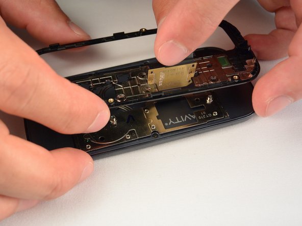

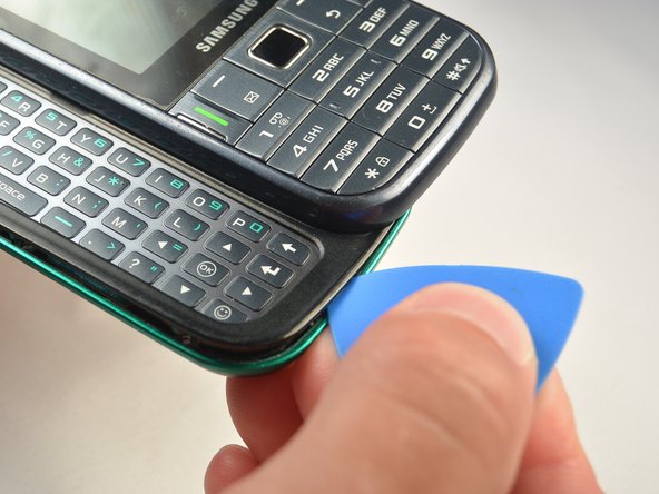

    2. Samsung Gravity TXT Screen Replacement: crwdns2935265:07crwdnd2935265:01crwdnd2935265:03crwdne2935265:0 Samsung Gravity TXT Screen Replacement: crwdns2935265:07crwdnd2935265:02crwdnd2935265:03crwdne2935265:0 Samsung Gravity TXT Screen Replacement: crwdns2935265:07crwdnd2935265:03crwdnd2935265:03crwdne2935265:0
      • Slide the keyboard out.
      • Use a Jimmy to separate a small segment of the plastic back frame from rest of the phone.
      • Starting at the bottom of the keyboard is recommended.
      • Slide an opening pick around the rest of the seam, starting at the gap just created with the Jimmy.
      • You will have to slide the keyboard back in to separate the back frame from the top have of the keyboard slider.
      • Lift the plastic back frame away.

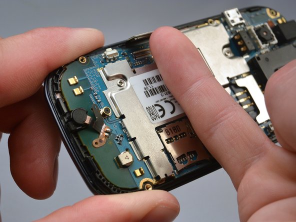

    1. Samsung Gravity TXT Screen Replacement, Motherboard: crwdns2935265:08crwdnd2935265:01crwdnd2935265:01crwdne2935265:0
      • Remove the two 3 mm Phillips #00 screws securing the motherboard to the front panel.
      • Do not try to pull the motherboad out just yet. The display data cable needs to be disconnected from the motherboad first.
    2. Samsung Gravity TXT Screen Replacement: crwdns2935265:09crwdnd2935265:01crwdnd2935265:03crwdne2935265:0 Samsung Gravity TXT Screen Replacement: crwdns2935265:09crwdnd2935265:02crwdnd2935265:03crwdne2935265:0 Samsung Gravity TXT Screen Replacement: crwdns2935265:09crwdnd2935265:03crwdnd2935265:03crwdne2935265:0
      • Use your finger nail to disconnect the display data cable from the motherboard.
    3. Samsung Gravity TXT Screen Replacement: crwdns2935265:010crwdnd2935265:01crwdnd2935265:02crwdne2935265:0 Samsung Gravity TXT Screen Replacement: crwdns2935265:010crwdnd2935265:02crwdnd2935265:02crwdne2935265:0
      • Carefully lift the main motherboard assembly away from the front panel.

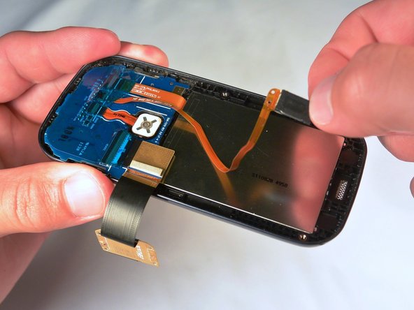

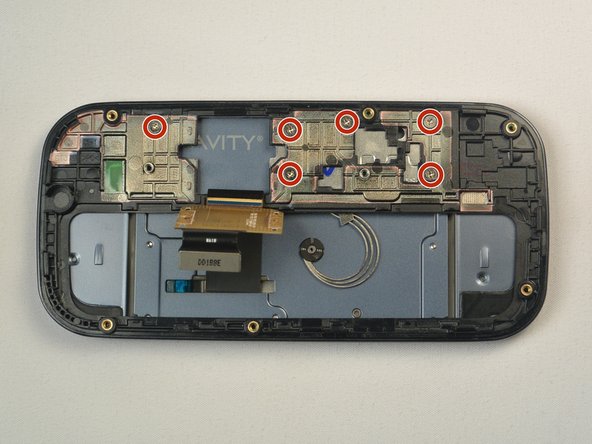

    1. Samsung Gravity TXT Screen Replacement, Screen: crwdns2935265:012crwdnd2935265:01crwdnd2935265:03crwdne2935265:0 Samsung Gravity TXT Screen Replacement, Screen: crwdns2935265:012crwdnd2935265:02crwdnd2935265:03crwdne2935265:0 Samsung Gravity TXT Screen Replacement, Screen: crwdns2935265:012crwdnd2935265:03crwdnd2935265:03crwdne2935265:0
      • Lift the ribbon off the plastic inner frame.
      • You may have to warm the adhesive using an iOpener to avoid damaging the ribbon.
      • Remove the six 1.2 mm #00 screws from the inner plastic frame.
      • Slide the ribbon through the slot on the inner frame while pulling the frame away.

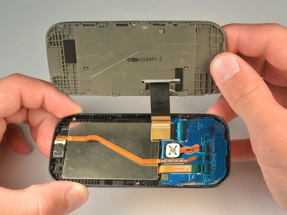

    2. Samsung Gravity TXT Screen Replacement: crwdns2935265:013crwdnd2935265:01crwdnd2935265:01crwdne2935265:0
      • Remove the four 2.4 mm #00 Phillips screws.
    3. Samsung Gravity TXT Screen Replacement: crwdns2935265:014crwdnd2935265:01crwdnd2935265:03crwdne2935265:0 Samsung Gravity TXT Screen Replacement: crwdns2935265:014crwdnd2935265:02crwdnd2935265:03crwdne2935265:0 Samsung Gravity TXT Screen Replacement: crwdns2935265:014crwdnd2935265:03crwdnd2935265:03crwdne2935265:0
      • Use a opening pick to separate the plastic back casing from the front of the phone by running it along the seam between the two.
      • Lift casing slightly away while sliding the ribbon through the slot in the casing.

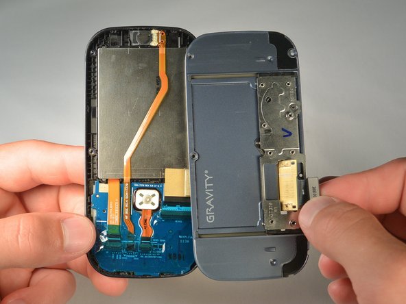

    4. Samsung Gravity TXT Screen Replacement: crwdns2935265:015crwdnd2935265:01crwdnd2935265:02crwdne2935265:0 Samsung Gravity TXT Screen Replacement: crwdns2935265:015crwdnd2935265:02crwdnd2935265:02crwdne2935265:0
      • Use a spudger to get underneath and remove the call speaker.

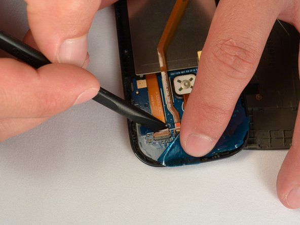

    5. Samsung Gravity TXT Screen Replacement: crwdns2935265:016crwdnd2935265:01crwdnd2935265:02crwdne2935265:0 Samsung Gravity TXT Screen Replacement: crwdns2935265:016crwdnd2935265:02crwdnd2935265:02crwdne2935265:0
      • Remove the plastic adhesive sheet to expose the ribbon cables
      • The use of an iOpener may be needed to soften the eadhesive
      • Use your finger or a spudger to pull the screen ribbon out of the connector

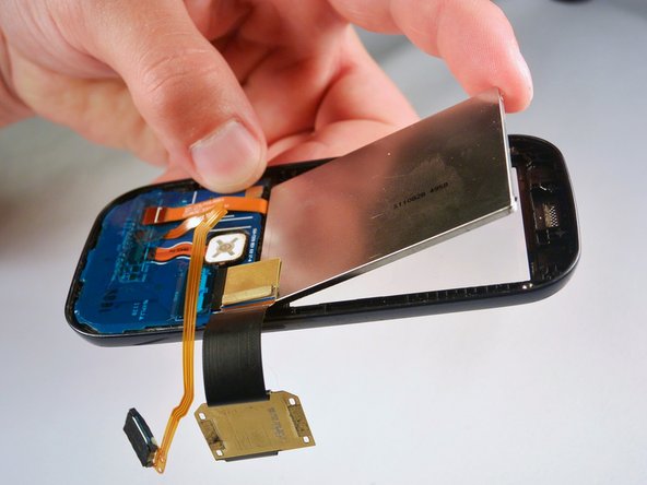

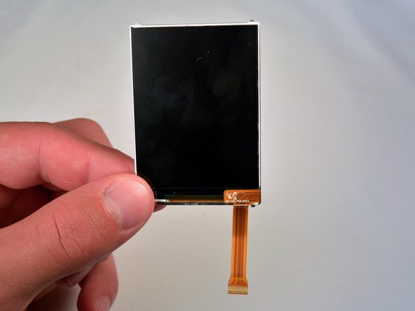

    6. Samsung Gravity TXT Screen Replacement: crwdns2935265:017crwdnd2935265:01crwdnd2935265:03crwdne2935265:0 Samsung Gravity TXT Screen Replacement: crwdns2935265:017crwdnd2935265:02crwdnd2935265:03crwdne2935265:0 Samsung Gravity TXT Screen Replacement: crwdns2935265:017crwdnd2935265:03crwdnd2935265:03crwdne2935265:0
      • Use a Jimmy to separate the screen from the rest of the phone
      • You may need to heat the perimeter of the screen with an iOpener to soften the adhesive.
      • Lift the screen away
