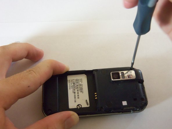

  3. Samsung Glyde Motherboard Replacement, Motherboard: crwdns2935265:03crwdnd2935265:01crwdnd2935265:02crwdne2935265:0 Samsung Glyde Motherboard Replacement, Motherboard: crwdns2935265:03crwdnd2935265:02crwdnd2935265:02crwdne2935265:0
    • Using a Phillips#00 screw driver, remove the six 4mm screws holding the back case together.

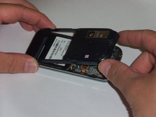

  4. Samsung Glyde Motherboard Replacement: crwdns2935265:04crwdnd2935265:01crwdnd2935265:02crwdne2935265:0 Samsung Glyde Motherboard Replacement: crwdns2935265:04crwdnd2935265:02crwdnd2935265:02crwdne2935265:0
    • Use a plastic opening tool to pry the case off. To do this, find a gap on any side of the phone, top preferably, and slip the tip of the tool in the gap
    • Now use moderate strength and slowly maneuver the tool around the outside until the case becomes loose.
    • Using your fingers, take the case off.

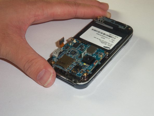

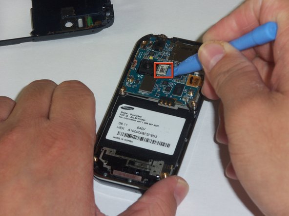

  5. Samsung Glyde Motherboard Replacement: crwdns2935265:05crwdnd2935265:01crwdnd2935265:02crwdne2935265:0 Samsung Glyde Motherboard Replacement: crwdns2935265:05crwdnd2935265:02crwdnd2935265:02crwdne2935265:0
    • The green film above the camera is the camera connector to the motherboard.
    • Use a plastic opening tool to disconnect the camera connector.

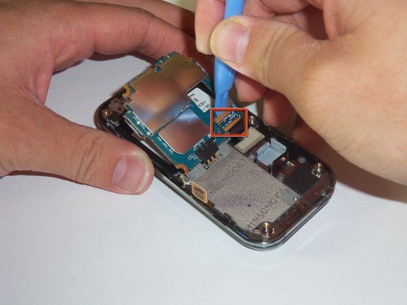

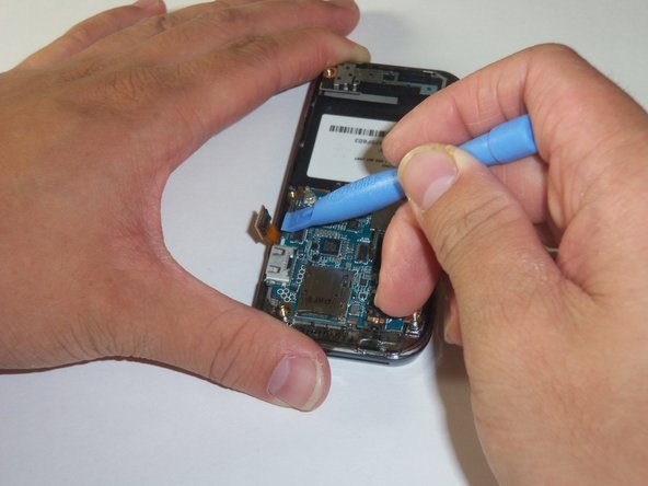

  6. Samsung Glyde Motherboard Replacement: crwdns2935265:06crwdnd2935265:01crwdnd2935265:02crwdne2935265:0 Samsung Glyde Motherboard Replacement: crwdns2935265:06crwdnd2935265:02crwdnd2935265:02crwdne2935265:0
    • The golden film connector connects the keyboard to the motherboard.
    • Use a plastic opening tool to disconnect the keyboard connector.

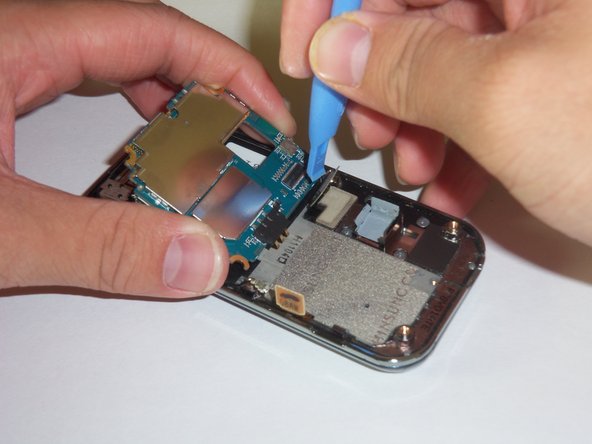

  8. Samsung Glyde Motherboard Replacement: crwdns2935265:08crwdnd2935265:01crwdnd2935265:03crwdne2935265:0 Samsung Glyde Motherboard Replacement: crwdns2935265:08crwdnd2935265:02crwdnd2935265:03crwdne2935265:0 Samsung Glyde Motherboard Replacement: crwdns2935265:08crwdnd2935265:03crwdnd2935265:03crwdne2935265:0
    • There is a LCD connector underneath the motherboard.
    • Gently lift the far edge of the motherboard upwards toward the center of the phone.
    • Using a plastic opening tool, disconnect the LCD connector.

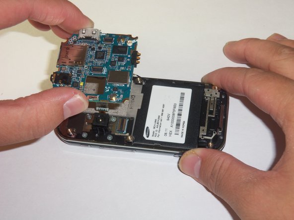

  9. Samsung Glyde Motherboard Replacement: crwdns2935265:09crwdnd2935265:01crwdnd2935265:02crwdne2935265:0 Samsung Glyde Motherboard Replacement: crwdns2935265:09crwdnd2935265:02crwdnd2935265:02crwdne2935265:0
    • After disconnecting the four connectors, gently lift the motherboard up with your fingers.
    • Place the motherboard in a secure area.
