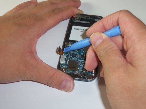

  6. Samsung Glyde LCD Screen Replacement: crwdns2935265:06crwdnd2935265:01crwdnd2935265:02crwdne2935265:0 Samsung Glyde LCD Screen Replacement: crwdns2935265:06crwdnd2935265:02crwdnd2935265:02crwdne2935265:0

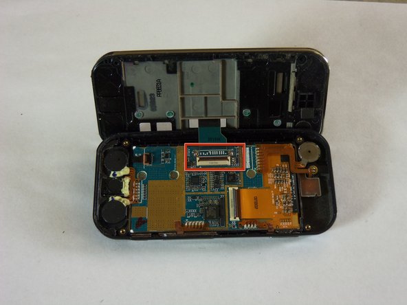

    • Take a close up of the picture for this step for a better view.
    • Use a plastic opening tool to disconnect the keyboard connector.

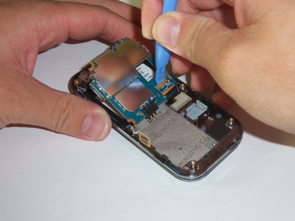

  7. Samsung Glyde LCD Screen Replacement: crwdns2935265:07crwdnd2935265:01crwdnd2935265:02crwdne2935265:0 Samsung Glyde LCD Screen Replacement: crwdns2935265:07crwdnd2935265:02crwdnd2935265:02crwdne2935265:0
    • The motherboard is held in place by the circular connector.
    • Using a plastic opening tool, disconnect the circular connector.

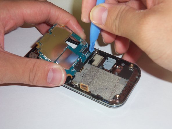

  8. Samsung Glyde LCD Screen Replacement: crwdns2935265:08crwdnd2935265:01crwdnd2935265:03crwdne2935265:0 Samsung Glyde LCD Screen Replacement: crwdns2935265:08crwdnd2935265:02crwdnd2935265:03crwdne2935265:0 Samsung Glyde LCD Screen Replacement: crwdns2935265:08crwdnd2935265:03crwdnd2935265:03crwdne2935265:0

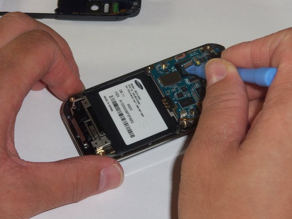

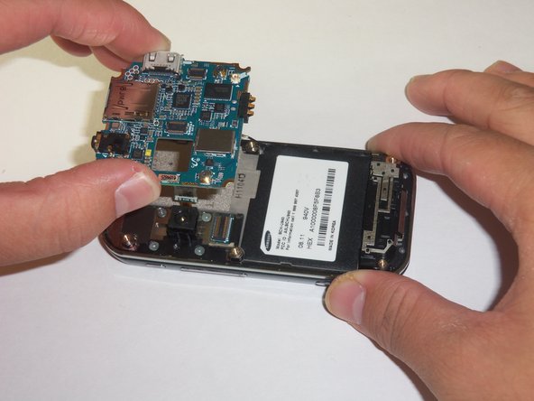

    • A LCD connector is located underneath the motherboard.
    • Lift the far edge of the motherboard gently upwards toward the center.
    • Using a plastic opening tool, disconnect the LCD connector.

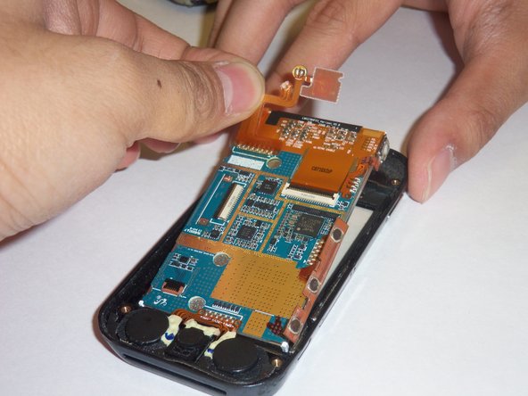

  9. Samsung Glyde LCD Screen Replacement: crwdns2935265:09crwdnd2935265:01crwdnd2935265:02crwdne2935265:0 Samsung Glyde LCD Screen Replacement: crwdns2935265:09crwdnd2935265:02crwdnd2935265:02crwdne2935265:0
    • Lift the motherboard up with your fingers.
    • Place the motherboard in a secure area.

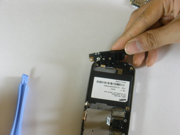

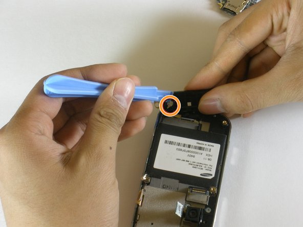

    • Look for the antenna which is located at the bottom end of the device. Prop the antenna out by using the plastic opening tool and slipping the tip of the tool into the edges of the antenna.
    • Using the plastic opening tool, disconnect the connector that leads from the phone to the antenna.
    • With your hands finish prying apart the antenna by lifting it up.

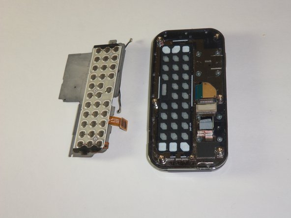

    • The keyboard chip is located on top of the device. Pry the keyboard off of the case with the plastic opening tool.

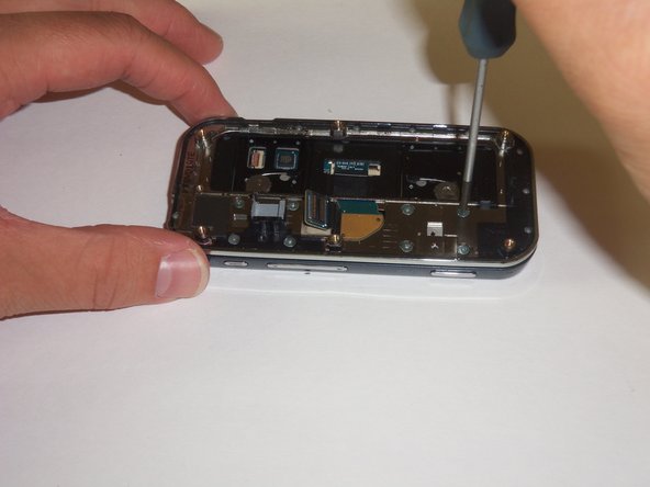

    • Using a #00 screwdriver, remove the 8 2mm screws connecting the display case to the sliding mechanism.
  13. Samsung Glyde LCD Screen Replacement: crwdns2935265:013crwdnd2935265:01crwdnd2935265:02crwdne2935265:0 Samsung Glyde LCD Screen Replacement: crwdns2935265:013crwdnd2935265:02crwdnd2935265:02crwdne2935265:0
    • Now remove the 5 4mm screws located under the sliding mechanism connecting the back-plate to the display.
    • You will need to maneuver the sliding mechanism around to reach all of the screws.

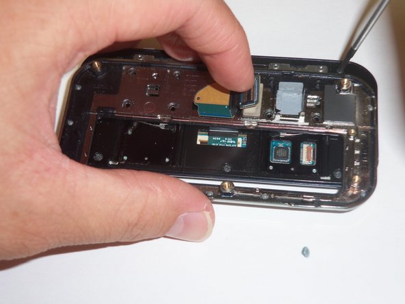

  14. Samsung Glyde LCD Screen Replacement: crwdns2935265:014crwdnd2935265:01crwdnd2935265:03crwdne2935265:0 Samsung Glyde LCD Screen Replacement: crwdns2935265:014crwdnd2935265:02crwdnd2935265:03crwdne2935265:0 Samsung Glyde LCD Screen Replacement: crwdns2935265:014crwdnd2935265:03crwdnd2935265:03crwdne2935265:0

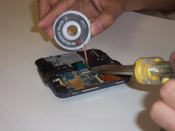

    • Now it's time to desolder some components. You can gain some instruction from here.
    • Using your soldering wick and a soldering iron, desolder the contacts of the flex cable.
  15. Samsung Glyde LCD Screen Replacement: crwdns2935265:015crwdnd2935265:01crwdnd2935265:01crwdne2935265:0
    • After desoldering, verify that the gates on the two flex cables are in the "up" position and remove them.

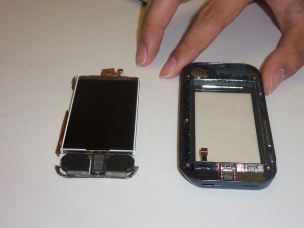

  16. Samsung Glyde LCD Screen Replacement: crwdns2935265:016crwdnd2935265:01crwdnd2935265:03crwdne2935265:0 Samsung Glyde LCD Screen Replacement: crwdns2935265:016crwdnd2935265:02crwdnd2935265:03crwdne2935265:0 Samsung Glyde LCD Screen Replacement: crwdns2935265:016crwdnd2935265:03crwdnd2935265:03crwdne2935265:0
    • Using gentle fingers, pry the LCD screen out of its housing.
    • The flex cables connecting everything to the LCD screen are very sensitive to touch, and don't react well to pulling/tearing motions.
