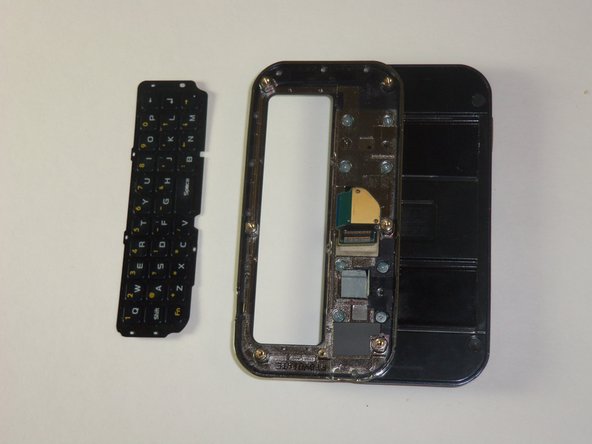

    • The keyboard chip is located on top of the device. Pry the keyboard off of the case with the plastic opening tool.
  12. Samsung Glyde Keypad Replacement, Keypad: crwdns2935265:012crwdnd2935265:01crwdnd2935265:02crwdne2935265:0 Samsung Glyde Keypad Replacement, Keypad: crwdns2935265:012crwdnd2935265:02crwdnd2935265:02crwdne2935265:0
    • To remove the keypad, slide out the display, and poke the keypad out.
