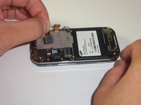

  10. Samsung Glyde Camera Replacement, Camera: crwdns2935265:010crwdnd2935265:01crwdnd2935265:02crwdne2935265:0 Samsung Glyde Camera Replacement, Camera: crwdns2935265:010crwdnd2935265:02crwdnd2935265:02crwdne2935265:0
    • Use your thumb and index finger to grip the camera connector.
    • Pull the camera connector upwards to detach the camera.
    • The camera was glued on, so this may require moderate strength.
