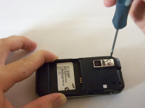

    • Using a Phillips #00 screwdriver, remove the six 4mm screws holding the back case together.

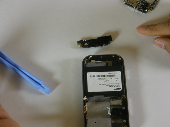

    • The antenna is located on the bottom of the phone. It is the small rectangular shaped object sticking out on one of the ends.
    • Use a plastic opening tool to prop the antenna out. To do so, slip the tip of the tool on one of the edges of the antenna. Use moderate pressure to pry the antenna out.
  6. Samsung Glyde Antenna Replacement: crwdns2935265:06crwdnd2935265:01crwdnd2935265:02crwdne2935265:0 Samsung Glyde Antenna Replacement: crwdns2935265:06crwdnd2935265:02crwdnd2935265:02crwdne2935265:0
    • Using a plastic opening tool, disconnect the connector leading from the antenna to the phone.
