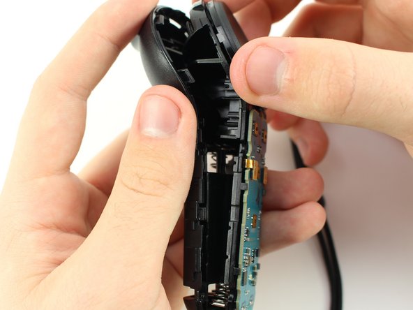

  4. Samsung Gear VR with Controller Motherboard Replacement: crwdns2935265:04crwdnd2935265:01crwdnd2935265:01crwdne2935265:0
    • Use the metal spudger to pry the back side of the controller apart from the front.
    • You will have to use the spudger in many different spots along the divide before trying to separate the pieces.
  5. Samsung Gear VR with Controller Motherboard Replacement: crwdns2935265:05crwdnd2935265:01crwdnd2935265:02crwdne2935265:0 Samsung Gear VR with Controller Motherboard Replacement: crwdns2935265:05crwdnd2935265:02crwdnd2935265:02crwdne2935265:0
    • Pull apart the two halves of the controller to access the motherboard.

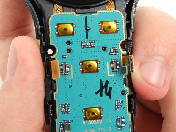

  6. Samsung Gear VR with Controller Motherboard Replacement: crwdns2935265:06crwdnd2935265:01crwdnd2935265:03crwdne2935265:0 Samsung Gear VR with Controller Motherboard Replacement: crwdns2935265:06crwdnd2935265:02crwdnd2935265:03crwdne2935265:0 Samsung Gear VR with Controller Motherboard Replacement: crwdns2935265:06crwdnd2935265:03crwdnd2935265:03crwdne2935265:0
    • Pry on the two pop connectors with the plastic opening tool to detach the motherboard.
    • Separate the motherboard and trackpad from the rear part of the controller.
