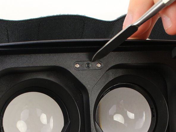

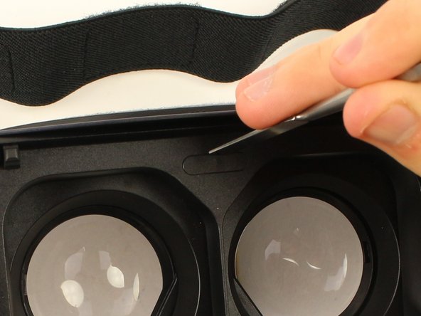

      • Remove the four corner screw covers with a metal spudger.
      • The screw covers fly off when removed, so make sure to keep track of them.
    3. Samsung Gear VR With Controller Trackpad Replacement: crwdns2935265:03crwdnd2935265:01crwdnd2935265:03crwdne2935265:0 Samsung Gear VR With Controller Trackpad Replacement: crwdns2935265:03crwdnd2935265:02crwdnd2935265:03crwdne2935265:0 Samsung Gear VR With Controller Trackpad Replacement: crwdns2935265:03crwdnd2935265:03crwdnd2935265:03crwdne2935265:0
      • Use a metal spudger to remove the screw cover centered at the top.
    4. Samsung Gear VR With Controller Trackpad Replacement: crwdns2935265:04crwdnd2935265:01crwdnd2935265:03crwdne2935265:0 Samsung Gear VR With Controller Trackpad Replacement: crwdns2935265:04crwdnd2935265:02crwdnd2935265:03crwdne2935265:0 Samsung Gear VR With Controller Trackpad Replacement: crwdns2935265:04crwdnd2935265:03crwdnd2935265:03crwdne2935265:0

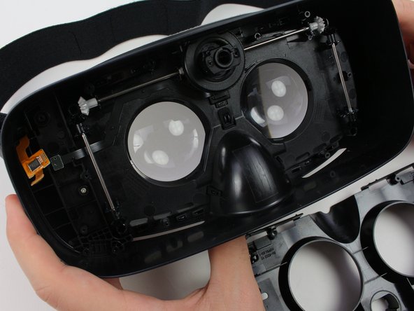

      • Remove the six 5mm Phillips #000 screws to detach the front phone mount.
      • Lift the front phone mount up and to the left.
      • Remove the front phone mount carefully because there is a wire harness on the left side of the headset.

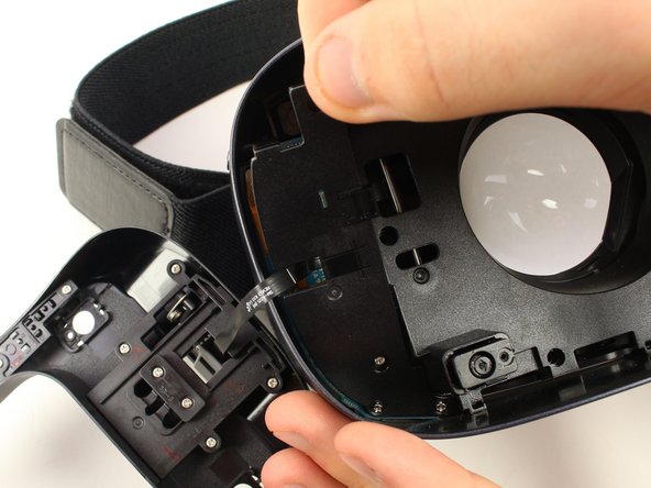

    5. Samsung Gear VR With Controller Trackpad Replacement: crwdns2935265:05crwdnd2935265:01crwdnd2935265:02crwdne2935265:0 Samsung Gear VR With Controller Trackpad Replacement: crwdns2935265:05crwdnd2935265:02crwdnd2935265:02crwdne2935265:0
      • Remove the four 5mm Phillips #000 screws that secure the plate on the left side of the headset.
      • Pull the plate away from the motherboard gently.
    6. Samsung Gear VR With Controller Trackpad Replacement: crwdns2935265:06crwdnd2935265:01crwdnd2935265:02crwdne2935265:0 Samsung Gear VR With Controller Trackpad Replacement: crwdns2935265:06crwdnd2935265:02crwdnd2935265:02crwdne2935265:0

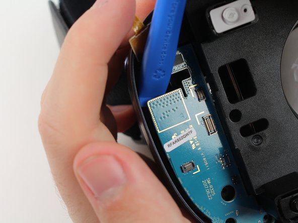

      • Use the iFixit opening tool to remove the pop connector holding the wire harness to the motherboard.
      • You can now completely remove the front phone mount from the headset.
    7. Samsung Gear VR With Controller Trackpad Replacement: crwdns2935265:07crwdnd2935265:01crwdnd2935265:03crwdne2935265:0 Samsung Gear VR With Controller Trackpad Replacement: crwdns2935265:07crwdnd2935265:02crwdnd2935265:03crwdne2935265:0 Samsung Gear VR With Controller Trackpad Replacement: crwdns2935265:07crwdnd2935265:03crwdnd2935265:03crwdne2935265:0
      • Remove the rest of the pop connectors on the motherboard using the iFixit opening tool.
      • Pry at the top of the motherboard with the iFixit opening tool to remove the motherboard.
      • The largest pop connector may require more effort to remove.
      • Make sure that nothing is connected to the motherboard before you pull it out.

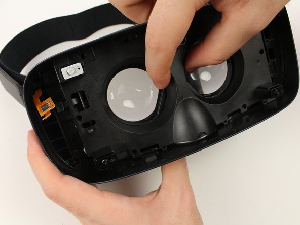

    8. Samsung Gear VR With Controller Trackpad Replacement: crwdns2935265:08crwdnd2935265:01crwdnd2935265:03crwdne2935265:0 Samsung Gear VR With Controller Trackpad Replacement: crwdns2935265:08crwdnd2935265:02crwdnd2935265:03crwdne2935265:0 Samsung Gear VR With Controller Trackpad Replacement: crwdns2935265:08crwdnd2935265:03crwdnd2935265:03crwdne2935265:0
      • Remove the eight 5mm Phillips #000 screws on the inner mask.
      • Gently separate the inner mask from the headset by pulling the mask from the inner sides of the lens sockets.
    1. Samsung Gear VR With Controller Trackpad Replacement, Trackpad: crwdns2935265:09crwdnd2935265:01crwdnd2935265:03crwdne2935265:0 Samsung Gear VR With Controller Trackpad Replacement, Trackpad: crwdns2935265:09crwdnd2935265:02crwdnd2935265:03crwdne2935265:0 Samsung Gear VR With Controller Trackpad Replacement, Trackpad: crwdns2935265:09crwdnd2935265:03crwdnd2935265:03crwdne2935265:0
      • Remove the one 5mm Phillips #000 screw to detach the trackpad from the headset.
      • Pry the trackpad loose from the headset using the spudger.
