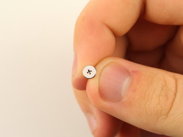

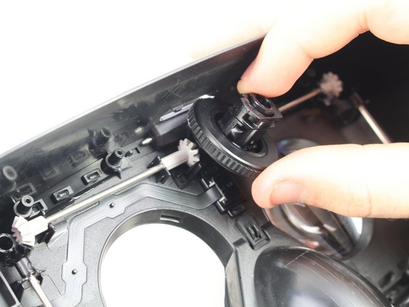

  9. Samsung Gear VR With Controller Focus Wheel  Replacement, Focus Wheel: crwdns2935265:09crwdnd2935265:01crwdnd2935265:03crwdne2935265:0 Samsung Gear VR With Controller Focus Wheel  Replacement, Focus Wheel: crwdns2935265:09crwdnd2935265:02crwdnd2935265:03crwdne2935265:0 Samsung Gear VR With Controller Focus Wheel  Replacement, Focus Wheel: crwdns2935265:09crwdnd2935265:03crwdnd2935265:03crwdne2935265:0
    • Remove the one 5mm Phillips #000 screw.
    • The screw for the focus wheel has a larger head than the rest of the screws.
    • Separate the focus wheel from the headset using your fingers.
