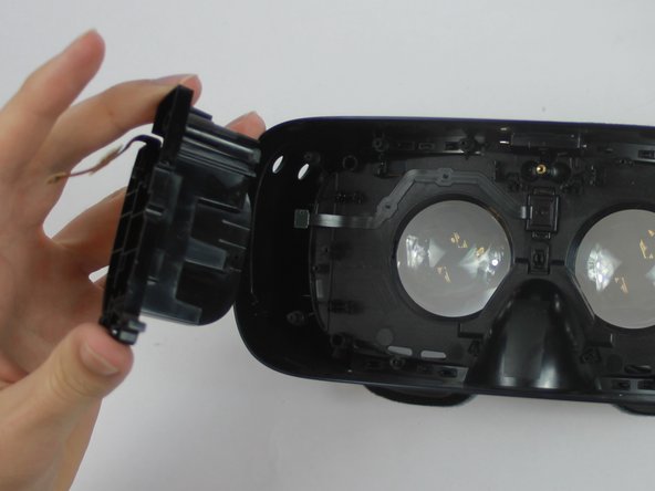

Navigating your mobile device while it is connected is accomplished through the use of a trackpad on the side of the headset. If the user becomes unable to control their device the trackpad may have come disconnected or may need replacement. This guide will outline how to access the headset's trackpad for repair or replacement.
The motherboard partially sits on the inner mask piece of the headset and must be removed in order to remove the inner mask piece.
Caution is required while working on the headset as a wire harness connects the USB adapter to the motherboard. Care should be taken not to put any strain on the wire and to open the headset from right to left.
    1. Samsung Gear VR Trackpad Replacement, Front Phone Mount: crwdns2935265:01crwdnd2935265:01crwdnd2935265:03crwdne2935265:0 Samsung Gear VR Trackpad Replacement, Front Phone Mount: crwdns2935265:01crwdnd2935265:02crwdnd2935265:03crwdne2935265:0 Samsung Gear VR Trackpad Replacement, Front Phone Mount: crwdns2935265:01crwdnd2935265:03crwdnd2935265:03crwdne2935265:0
      • Remove the front cover to access a plate that holds the phone in place during use.
      • Remove the four corner screw covers with a metal spudger to reveal four screws.
      • Remove the sticker located at the top center to reveal two additional screws.
    2. Samsung Gear VR Trackpad Replacement: crwdns2935265:02crwdnd2935265:01crwdnd2935265:02crwdne2935265:0 Samsung Gear VR Trackpad Replacement: crwdns2935265:02crwdnd2935265:02crwdnd2935265:02crwdne2935265:0
      • Using the PH000 tip remove the six 0.5 cm screws that secure the front phone mount.
      • After the six 0.5 cm screws are completely removed lift the front phone mount up and to the left.
      • When handling your equipment be careful not to strain the wire harness located on the left side of the headset.
