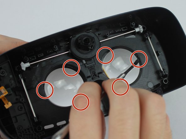

    1. Samsung Gear VR Lens Replacement, Lens: crwdns2935265:06crwdnd2935265:01crwdnd2935265:02crwdne2935265:0 Samsung Gear VR Lens Replacement, Lens: crwdns2935265:06crwdnd2935265:02crwdnd2935265:02crwdne2935265:0
      • Using the metal spudger, push in the 3 tabs around the lens housing to release the lens. Repeat for both lens for a total of 6 tabs.
      • Do not push in too hard or you might brake the tabs.
    2. Samsung Gear VR Lens Replacement: crwdns2935265:07crwdnd2935265:01crwdnd2935265:01crwdne2935265:0
      • Flip the headgear and use your fingers to gently remove lens from mask. Repeat for both lens.
