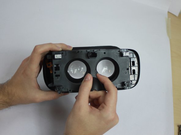

    1. Samsung Gear VR Focus Wheel Replacement, Inner Mask: crwdns2935265:05crwdnd2935265:01crwdnd2935265:03crwdne2935265:0 Samsung Gear VR Focus Wheel Replacement, Inner Mask: crwdns2935265:05crwdnd2935265:02crwdnd2935265:03crwdne2935265:0 Samsung Gear VR Focus Wheel Replacement, Inner Mask: crwdns2935265:05crwdnd2935265:03crwdnd2935265:03crwdne2935265:0
      • Using the PH000 tip remove the eight 0.5 cm screws from the Inner Mask
      • Carefully remove the Inner Mask by pulling it from the inner side of the lenses socket.

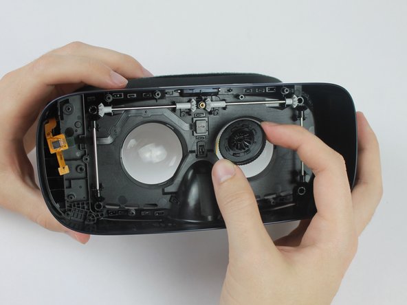

    1. Samsung Gear VR Focus Wheel Replacement, Focus Wheel: crwdns2935265:06crwdnd2935265:01crwdnd2935265:02crwdne2935265:0 Samsung Gear VR Focus Wheel Replacement, Focus Wheel: crwdns2935265:06crwdnd2935265:02crwdnd2935265:02crwdne2935265:0
      • Use your fingers to gently remove focus wheel.
