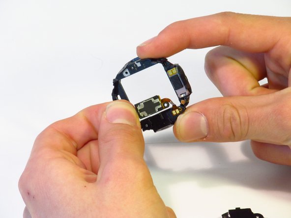

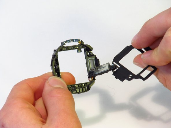

  12. Samsung Gear S3 Frontier Speaker Replacement: crwdns2935265:012crwdnd2935265:01crwdnd2935265:03crwdne2935265:0 Samsung Gear S3 Frontier Speaker Replacement: crwdns2935265:012crwdnd2935265:02crwdnd2935265:03crwdne2935265:0 Samsung Gear S3 Frontier Speaker Replacement: crwdns2935265:012crwdnd2935265:03crwdnd2935265:03crwdne2935265:0
    • Separate the two parts of the chassis.
    • The speaker is located on the bulkier half of the chassis (see third image).
  13. Samsung Gear S3 Frontier Speaker Replacement: crwdns2935265:013crwdnd2935265:01crwdnd2935265:02crwdne2935265:0 Samsung Gear S3 Frontier Speaker Replacement: crwdns2935265:013crwdnd2935265:02crwdnd2935265:02crwdne2935265:0
    • Remove the connection from the chassis with tweezers.
    • Attempting to remove the connection by grabbing the speaker itself may result in damage to the speaker and it's connection.
    • Separate the speaker from the chassis.
