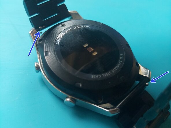

    • Pull back the locking tabs to release the bracelet so it`s out of the way.
    • Remove the four Y wing screws.
    • Use a prying tool to separate the back from the watch. Go all the way around and do not pry only in one place, because you can damage the plastic back.

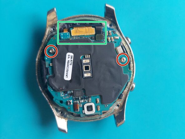

    • Remove the two Phillips screws and disconnect the three connectors.
    • Use a plastic prying tool to CAREFULLY lift up the motherboard. The battery is glued to it, so it can be a bit difficult. Have patience, this step is crucual!
    • Use a prying tool to lift up the battery connector. It is glued to the surface, but should come out easily.
