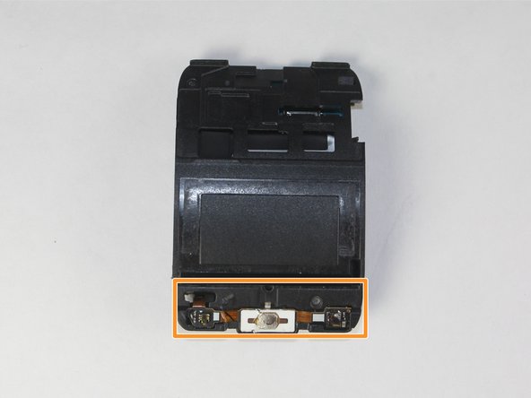

    1. Samsung Gear S Home Button Assembly Replacement, Home Button Assembly: crwdns2935265:07crwdnd2935265:01crwdnd2935265:02crwdne2935265:0 Samsung Gear S Home Button Assembly Replacement, Home Button Assembly: crwdns2935265:07crwdnd2935265:02crwdnd2935265:02crwdne2935265:0
      • Locate the home ribbon connector attached to the wrist side (side that faces the user when wearing it) of the motherboard assembly.
      • Locate the home ribbon assembly attached to the screen side of the motherboard assembly.
    2. Samsung Gear S Home Button Assembly Replacement: crwdns2935265:08crwdnd2935265:01crwdnd2935265:01crwdne2935265:0
      • Use a plastic opening tool to gently pry up on the home ribbon connector.
    3. Samsung Gear S Home Button Assembly Replacement: crwdns2935265:09crwdnd2935265:01crwdnd2935265:01crwdne2935265:0
      • Use the spudger to pry up the home ribbon assembly.
