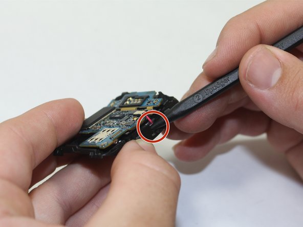

  9. Samsung Gear S Battery/ Motherboard Replacement: crwdns2935265:09crwdnd2935265:01crwdnd2935265:01crwdne2935265:0
    • Once the motherboard and the battery are removed, disconnect the battery at the connector.
  10. Samsung Gear S Battery/ Motherboard Replacement: crwdns2935265:010crwdnd2935265:01crwdnd2935265:02crwdne2935265:0 Samsung Gear S Battery/ Motherboard Replacement: crwdns2935265:010crwdnd2935265:02crwdnd2935265:02crwdne2935265:0
    • Use a spudger to gently pry upward on the clasp connecting the battery to the motherboard.
