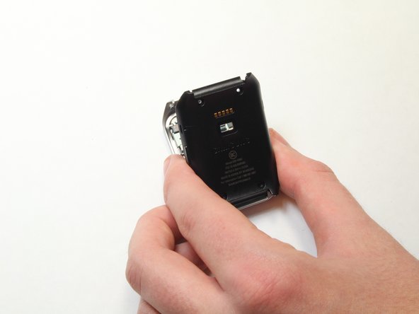

  6. Samsung Gear Live Motherboard Replacement, Pry off the back of the watch.: crwdns2935265:06crwdnd2935265:01crwdnd2935265:01crwdne2935265:0
    • Gently work the plastic opening tool under the top edge of the watch’s back cover.
  7. Samsung Gear Live Motherboard Replacement, Lift off the back cover: crwdns2935265:07crwdnd2935265:01crwdnd2935265:02crwdne2935265:0 Samsung Gear Live Motherboard Replacement, Lift off the back cover: crwdns2935265:07crwdnd2935265:02crwdnd2935265:02crwdne2935265:0
    • With the watch’s back cover pried loose, gently lift it away from the front half of the watch.

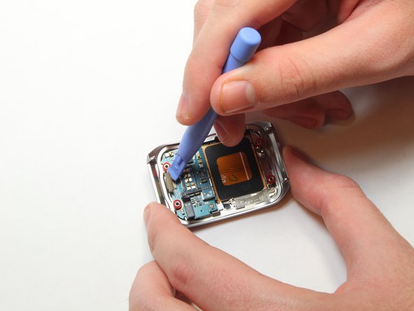

    • Locate the ribbon cable connector near the edge of the watch's case.
    • Using the plastic opening tool, gently pry the connector from the motherboard

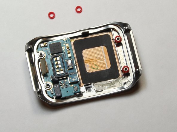

  10. Samsung Gear Live Motherboard Replacement, Remove the red spacers: crwdns2935265:010crwdnd2935265:01crwdnd2935265:02crwdne2935265:0 Samsung Gear Live Motherboard Replacement, Remove the red spacers: crwdns2935265:010crwdnd2935265:02crwdnd2935265:02crwdne2935265:0
    • Using the plastic opening tool, gently pry away the red spacers.
    • Set the spacers aside.
  11. Samsung Gear Live Motherboard Replacement, Pry up the motherboard: crwdns2935265:011crwdnd2935265:01crwdnd2935265:03crwdne2935265:0 Samsung Gear Live Motherboard Replacement, Pry up the motherboard: crwdns2935265:011crwdnd2935265:02crwdnd2935265:03crwdne2935265:0 Samsung Gear Live Motherboard Replacement, Pry up the motherboard: crwdns2935265:011crwdnd2935265:03crwdnd2935265:03crwdne2935265:0
    • Insert the end of the plastic opening tool under the motherboard.
    • Gently pry up the motherboard.
