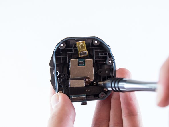

  14. Samsung Gear 360 Rear Camera Replacement, Rear Camera: crwdns2935265:014crwdnd2935265:01crwdnd2935265:02crwdne2935265:0 Samsung Gear 360 Rear Camera Replacement, Rear Camera: crwdns2935265:014crwdnd2935265:02crwdnd2935265:02crwdne2935265:0
    • Within the grey half of the case, unscrew both Phillips #00 0.75 mm screws located on the metal plate using PH00 screwdriver.
  15. Samsung Gear 360 Rear Camera Replacement: crwdns2935265:015crwdnd2935265:01crwdnd2935265:02crwdne2935265:0 Samsung Gear 360 Rear Camera Replacement: crwdns2935265:015crwdnd2935265:02crwdnd2935265:02crwdne2935265:0
    • Once the screws have been removed, remove the metal plate.

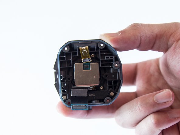

  16. Samsung Gear 360 Rear Camera Replacement: crwdns2935265:016crwdnd2935265:01crwdnd2935265:02crwdne2935265:0 Samsung Gear 360 Rear Camera Replacement: crwdns2935265:016crwdnd2935265:02crwdnd2935265:02crwdne2935265:0
    • Using a PH000 screwdriver head, remove the both Phillips #000 0.75 mm screws on the grey case.
  17. Samsung Gear 360 Rear Camera Replacement: crwdns2935265:017crwdnd2935265:01crwdnd2935265:02crwdne2935265:0 Samsung Gear 360 Rear Camera Replacement: crwdns2935265:017crwdnd2935265:02crwdnd2935265:02crwdne2935265:0
    • Using a plastic opening tool, remove the plastic cover underneath the rear camera

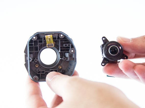

  18. Samsung Gear 360 Rear Camera Replacement: crwdns2935265:018crwdnd2935265:01crwdnd2935265:02crwdne2935265:0 Samsung Gear 360 Rear Camera Replacement: crwdns2935265:018crwdnd2935265:02crwdnd2935265:02crwdne2935265:0
    • Gently remove the rear camera module by using a plastic opening tool and lifting the module.
