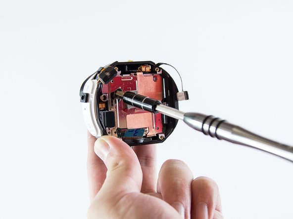

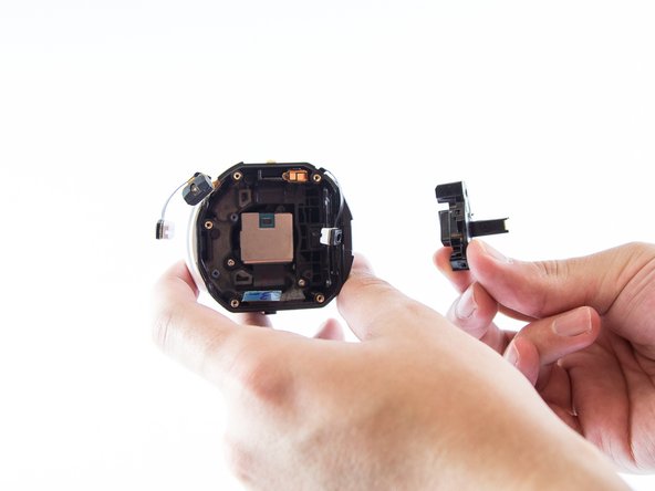

    • Remove all Phillips #00 0.75 mm screws from the body of the camera using a PH00 screwdriver head.
  11. Samsung Gear 360 Front Camera Replacement: crwdns2935265:011crwdnd2935265:01crwdnd2935265:03crwdne2935265:0 Samsung Gear 360 Front Camera Replacement: crwdns2935265:011crwdnd2935265:02crwdnd2935265:03crwdne2935265:0 Samsung Gear 360 Front Camera Replacement: crwdns2935265:011crwdnd2935265:03crwdnd2935265:03crwdne2935265:0
    • Carefully lift the three sensors off using a plastic opening tool and pull them aside.

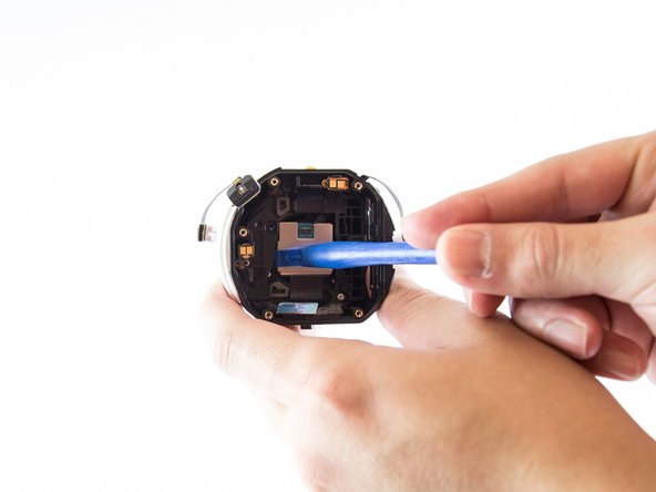

    • Carefully use a plastic opening tool to separate the gray case from the black case on the device.
  13. Samsung Gear 360 Front Camera Replacement: crwdns2935265:013crwdnd2935265:01crwdnd2935265:03crwdne2935265:0 Samsung Gear 360 Front Camera Replacement: crwdns2935265:013crwdnd2935265:02crwdnd2935265:03crwdne2935265:0 Samsung Gear 360 Front Camera Replacement: crwdns2935265:013crwdnd2935265:03crwdnd2935265:03crwdne2935265:0

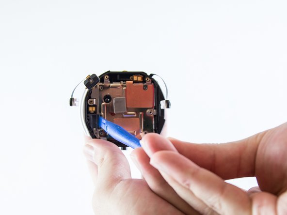

    • Insert a plastic removal tool underneath the four sensors on the motherboard to fully separate the camera case.
  14. Samsung Gear 360 Front Camera Replacement, Speaker: crwdns2935265:014crwdnd2935265:01crwdnd2935265:03crwdne2935265:0 Samsung Gear 360 Front Camera Replacement, Speaker: crwdns2935265:014crwdnd2935265:02crwdnd2935265:03crwdne2935265:0 Samsung Gear 360 Front Camera Replacement, Speaker: crwdns2935265:014crwdnd2935265:03crwdnd2935265:03crwdne2935265:0
    • Within gold metal half of the case, unscrew the Phillips #00 0.75 mm screw located on the metal plate using a PH00 screwdriver.
    • Using a plastic opening tool, remove the metal cover.
