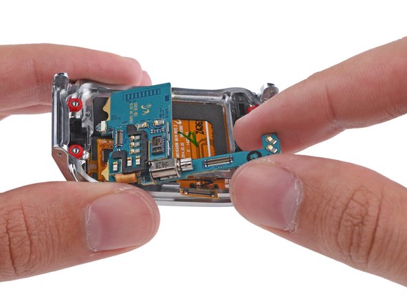

  10. Samsung Gear 2 Teardown: crwdns2935265:010crwdnd2935265:01crwdnd2935265:02crwdne2935265:0 Samsung Gear 2 Teardown: crwdns2935265:010crwdnd2935265:02crwdnd2935265:02crwdne2935265:0
    • The LCD and digitizer connect to the motherboard via a single cable, which also serves to hold the board in, like a cute little seatbelt.
    • With the connector out of the way, the board is free to roam, with all of its efficiently-packed peripherals strapped in for the ride.
    • A few non-modular components are soldered to the board: IR LED (for TV remote functionality), heartrate monitor, and vibrator motor.
