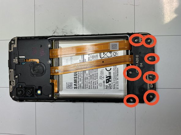

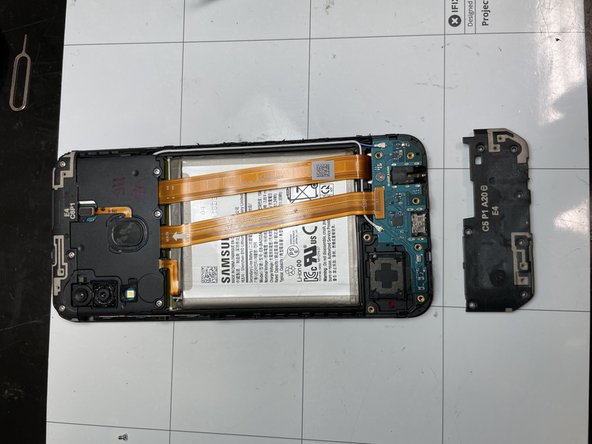

  3. Samsung Galaxy a20e Charging Board Replacement, Removal of the charging board cover: crwdns2935265:03crwdnd2935265:01crwdnd2935265:02crwdne2935265:0 Samsung Galaxy a20e Charging Board Replacement, Removal of the charging board cover: crwdns2935265:03crwdnd2935265:02crwdnd2935265:02crwdne2935265:0
    • Remove the seven Philips #00 screws.
    • Remove the charging board cover.
  4. Samsung Galaxy a20e Charging Board Replacement: crwdns2935265:04crwdnd2935265:01crwdnd2935265:03crwdne2935265:0 Samsung Galaxy a20e Charging Board Replacement: crwdns2935265:04crwdnd2935265:02crwdnd2935265:03crwdne2935265:0 Samsung Galaxy a20e Charging Board Replacement: crwdns2935265:04crwdnd2935265:03crwdnd2935265:03crwdne2935265:0

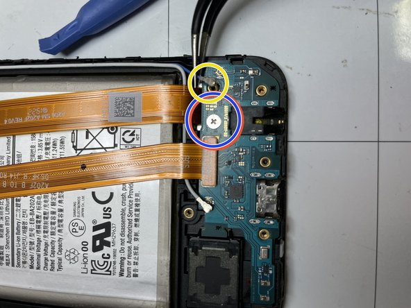

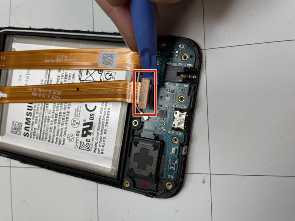

    • Disconnect the connector that connects the logic board.
    • Disconnect the white wire.
    • Disconnect the blue wire.

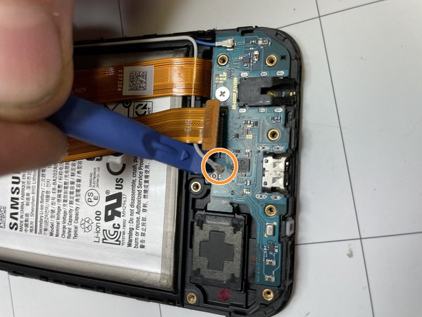

    • Unscrew the Philips #00 screw.

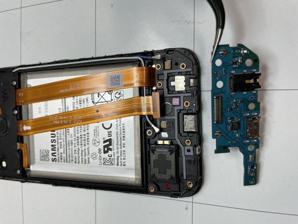

  5. Samsung Galaxy a20e Charging Board Replacement, Charging Board Removal: crwdns2935265:05crwdnd2935265:01crwdnd2935265:02crwdne2935265:0 Samsung Galaxy a20e Charging Board Replacement, Charging Board Removal: crwdns2935265:05crwdnd2935265:02crwdnd2935265:02crwdne2935265:0

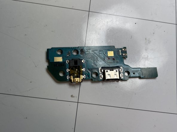

    • Remove the charging board and replace it with the new one.
In order to reassemble your device, follow the instructions in reverse order.
