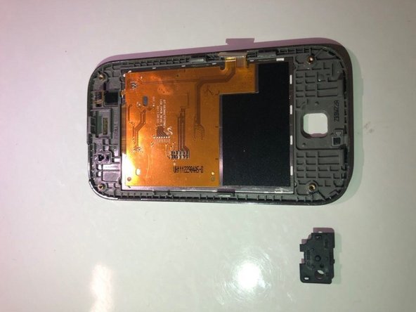

  4. Samsung Galaxy Y s5360 Home Button Replacement: crwdns2935265:04crwdnd2935265:01crwdnd2935265:03crwdne2935265:0 Samsung Galaxy Y s5360 Home Button Replacement: crwdns2935265:04crwdnd2935265:02crwdnd2935265:03crwdne2935265:0 Samsung Galaxy Y s5360 Home Button Replacement: crwdns2935265:04crwdnd2935265:03crwdnd2935265:03crwdne2935265:0
    • Disconnect the orange motherboard connection, then remove the interior hardware from the front screen display.
  5. Samsung Galaxy Y s5360 Home Button Replacement, Home Button: crwdns2935265:05crwdnd2935265:01crwdnd2935265:02crwdne2935265:0 Samsung Galaxy Y s5360 Home Button Replacement, Home Button: crwdns2935265:05crwdnd2935265:02crwdnd2935265:02crwdne2935265:0
    • Remove the Home Button from the device.
