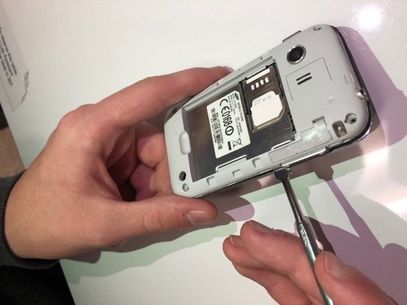

    • Use the blue plastic opening tool to pry the back-panel off of the device.

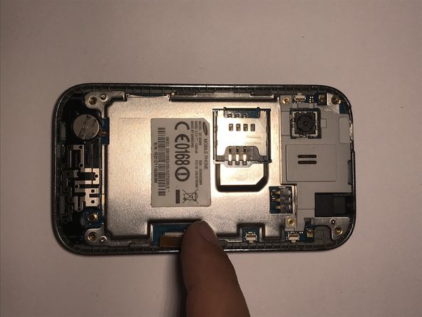

    • Use the screwdriver with a Phillips #000 screwdriver head to remove the four 5mm screws located in the corner of the interior back panel.
    • Remove the SD card as well by sliding the card out of it's slot.
  3. Samsung Galaxy Y Touch Screen Replacement: crwdns2935265:03crwdnd2935265:01crwdnd2935265:03crwdne2935265:0 Samsung Galaxy Y Touch Screen Replacement: crwdns2935265:03crwdnd2935265:02crwdnd2935265:03crwdne2935265:0 Samsung Galaxy Y Touch Screen Replacement: crwdns2935265:03crwdnd2935265:03crwdnd2935265:03crwdne2935265:0
    • Use the metal pry tool to separate the interior back panel from the interior hardware and screen.
    • Using a metal spudger may cause further damage to your device.

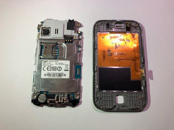

    • Disconnect the orange motherboard connection, then remove the interior hardware from the front screen display.
