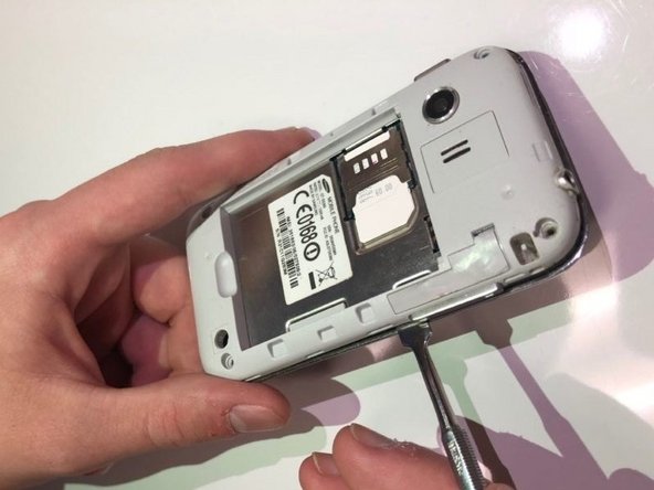

    • Use the blue plastic opening tool to pry the back-panel off of the device.

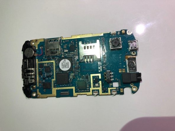

    • Use the screwdriver with a PH000 screwdriver head to remove the four 5mm screws located in the corner of the interior back panel.
    • Remove the SD card as well by sliding the card out of it's slot.

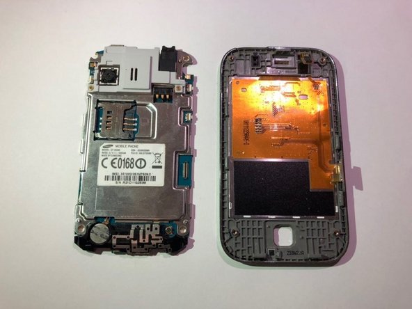

    • Use metal pry tool to separate the interior back panel from the interior hardware and screen.
  4. Samsung Galaxy Y Charging port and headphone jack Replacement: crwdns2935265:04crwdnd2935265:01crwdnd2935265:03crwdne2935265:0 Samsung Galaxy Y Charging port and headphone jack Replacement: crwdns2935265:04crwdnd2935265:02crwdnd2935265:03crwdne2935265:0 Samsung Galaxy Y Charging port and headphone jack Replacement: crwdns2935265:04crwdnd2935265:03crwdnd2935265:03crwdne2935265:0

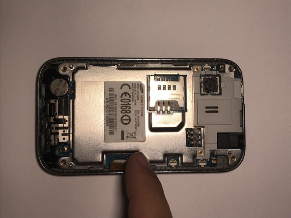

    • Disconnect the orange motherboard connection, then remove interior hardware from the front screen display.

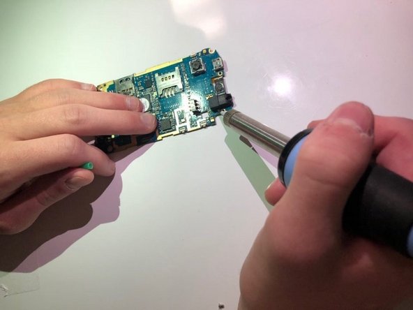

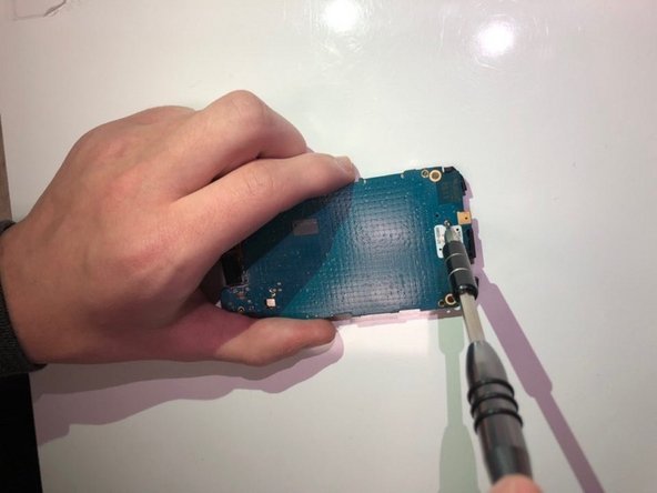

    • Use a Phillips #000 screwdriver to remove the five 2mm screws located in the corner of the silver protective panel.
    • If the motherboard is cracked or damaged, then replace with a new one.
