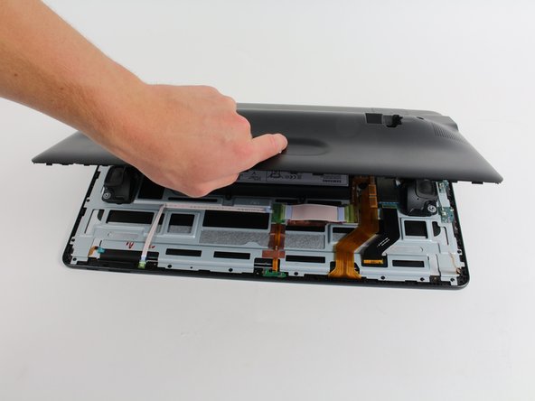

  5. Samsung Galaxy View Sound and Power Buttons Replacement: crwdns2935265:05crwdnd2935265:01crwdnd2935265:03crwdne2935265:0 Samsung Galaxy View Sound and Power Buttons Replacement: crwdns2935265:05crwdnd2935265:02crwdnd2935265:03crwdne2935265:0 Samsung Galaxy View Sound and Power Buttons Replacement: crwdns2935265:05crwdnd2935265:03crwdnd2935265:03crwdne2935265:0
    • Insert the plastic opening tool between the seam of the back panel and the front casing to create an initial opening.
    • Insert the metal spudger within the opening.
    • Move the metal spudger down the seam, prying the back panel open as you go.
    • Once a large enough opening is made, pry the entire back panel off with your hand.
    • You will hear loud popping from the magnetized latches. This is not causing damage to the device and will require some force to open.

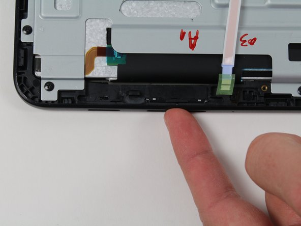

  8. Samsung Galaxy View Sound and Power Buttons Replacement, Sound and Power Buttons: crwdns2935265:08crwdnd2935265:01crwdnd2935265:01crwdne2935265:0
    • Use your fingers to pull the blue no-fuss ribbon cable connector to the right of the metal bar, up and away from its connection.
  9. Samsung Galaxy View Sound and Power Buttons Replacement: crwdns2935265:09crwdnd2935265:01crwdnd2935265:02crwdne2935265:0 Samsung Galaxy View Sound and Power Buttons Replacement: crwdns2935265:09crwdnd2935265:02crwdnd2935265:02crwdne2935265:0
    • Use the tweezers to pick up the metal bar starting with one side and moving to the other.
    • Lift it straight up from the device.
  10. Samsung Galaxy View Sound and Power Buttons Replacement: crwdns2935265:010crwdnd2935265:01crwdnd2935265:03crwdne2935265:0 Samsung Galaxy View Sound and Power Buttons Replacement: crwdns2935265:010crwdnd2935265:02crwdnd2935265:03crwdne2935265:0 Samsung Galaxy View Sound and Power Buttons Replacement: crwdns2935265:010crwdnd2935265:03crwdnd2935265:03crwdne2935265:0
    • Use your fingers to gently push each button through the hole in the device.
    • Use the tweezers to pick up the loose buttons and remove them from the device.
