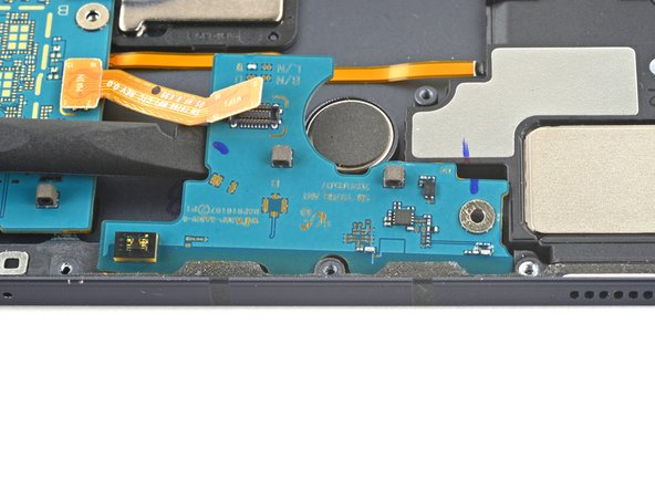

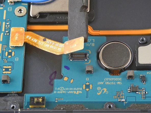

  22. Samsung Galaxy Tab S7 Plus Vibrator Replacement, Disconnect the antenna board's interconnect cable: crwdns2935265:022crwdnd2935265:01crwdnd2935265:02crwdne2935265:0 Samsung Galaxy Tab S7 Plus Vibrator Replacement, Disconnect the antenna board's interconnect cable: crwdns2935265:022crwdnd2935265:02crwdnd2935265:02crwdne2935265:0
    • Use the flat end of a spudger to pry up and disconnect the antenna board interconnect cable's press connector secured to the antenna board.

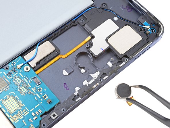

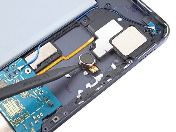

  26. Samsung Galaxy Tab S7 Plus Vibrator Replacement, Remove the vibrator: crwdns2935265:026crwdnd2935265:01crwdnd2935265:03crwdne2935265:0 Samsung Galaxy Tab S7 Plus Vibrator Replacement, Remove the vibrator: crwdns2935265:026crwdnd2935265:02crwdnd2935265:03crwdne2935265:0 Samsung Galaxy Tab S7 Plus Vibrator Replacement, Remove the vibrator: crwdns2935265:026crwdnd2935265:03crwdnd2935265:03crwdne2935265:0
    • Insert the point of a spudger in the gap between the vibrator and the frame.
    • Pry up with the spudger to disconnect the vibrator.
    • If you're having trouble separating the vibrator from the frame, apply more isopropyl alcohol; it may take a while for the adhesive to loosen.
    • Use tweezers, or your fingers, to remove the vibrator.
    • If there's any alcohol remaining, use a lint-free cloth to wipe it off or allow it to dry completely before installing a new vibrator.
