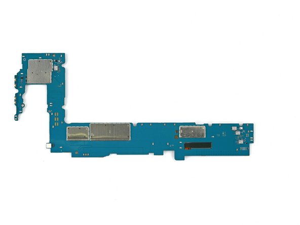

  37. Samsung Galaxy Tab S7 Plus Motherboard Replacement, Unfasten the motherboard: crwdns2935265:037crwdnd2935265:01crwdnd2935265:02crwdne2935265:0 Samsung Galaxy Tab S7 Plus Motherboard Replacement, Unfasten the motherboard: crwdns2935265:037crwdnd2935265:02crwdnd2935265:02crwdne2935265:0
    • Use a Phillips #00 screwdriver to remove the three 2 mm screws securing the motherboard to the frame.
  38. Samsung Galaxy Tab S7 Plus Motherboard Replacement, Remove the motherboard: crwdns2935265:038crwdnd2935265:01crwdnd2935265:03crwdne2935265:0 Samsung Galaxy Tab S7 Plus Motherboard Replacement, Remove the motherboard: crwdns2935265:038crwdnd2935265:02crwdnd2935265:03crwdne2935265:0 Samsung Galaxy Tab S7 Plus Motherboard Replacement, Remove the motherboard: crwdns2935265:038crwdnd2935265:03crwdnd2935265:03crwdne2935265:0
    • Insert a spudger into a gap between the motherboard and the frame.
    • Pry up with the spudger to release the motherboard from its clips.
    • Remove the motherboard.
    • During reassembly, refasten the motherboard screws first to properly align it into place, then reconnect the cables.
  39. Samsung Galaxy Tab S7 Plus Motherboard Replacement, Only the motherboard remains: crwdns2935265:039crwdnd2935265:01crwdnd2935265:02crwdne2935265:0 Samsung Galaxy Tab S7 Plus Motherboard Replacement, Only the motherboard remains: crwdns2935265:039crwdnd2935265:02crwdnd2935265:02crwdne2935265:0
    • You're now left with the motherboard.
Compare your new replacement part to the original part—you may need to transfer remaining components or remove adhesive backings from the new part before you install it.
