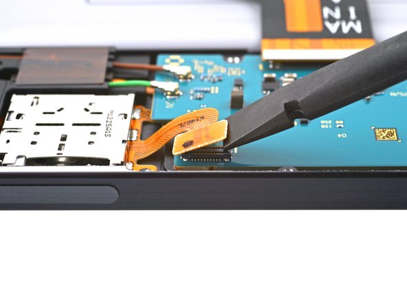

    • Use the flat end of a spudger to pry up and disconnect the daughterboard interconnect cable's press connector secured to the motherboard.

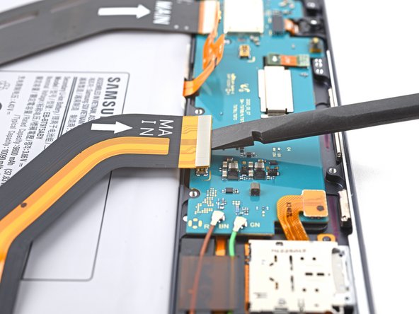

  25. Samsung Galaxy Tab S7 Plus Loudspeaker Assembly Replacement, Disconnect the keyboard dock port cable: crwdns2935265:025crwdnd2935265:01crwdnd2935265:02crwdne2935265:0 Samsung Galaxy Tab S7 Plus Loudspeaker Assembly Replacement, Disconnect the keyboard dock port cable: crwdns2935265:025crwdnd2935265:02crwdnd2935265:02crwdne2935265:0
    • Use the flat end of a spudger to pry up and disconnect the keyboard dock port cable's press connector secured to the motherboard.

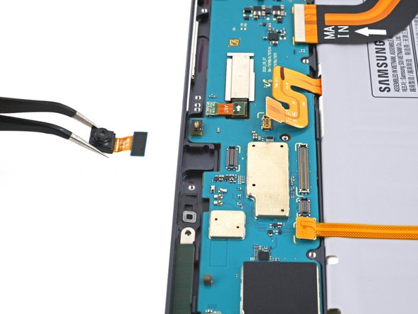

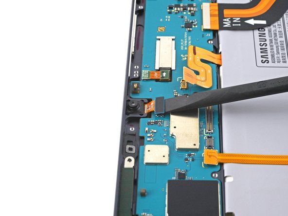

  26. Samsung Galaxy Tab S7 Plus Loudspeaker Assembly Replacement, Remove the front camera: crwdns2935265:026crwdnd2935265:01crwdnd2935265:03crwdne2935265:0 Samsung Galaxy Tab S7 Plus Loudspeaker Assembly Replacement, Remove the front camera: crwdns2935265:026crwdnd2935265:02crwdnd2935265:03crwdne2935265:0 Samsung Galaxy Tab S7 Plus Loudspeaker Assembly Replacement, Remove the front camera: crwdns2935265:026crwdnd2935265:03crwdnd2935265:03crwdne2935265:0
    • Use the flat end of a spudger to pry up and disconnect the front camera's press connector secured to the motherboard.
    • Use tweezers, or your fingers, to remove the front camera.

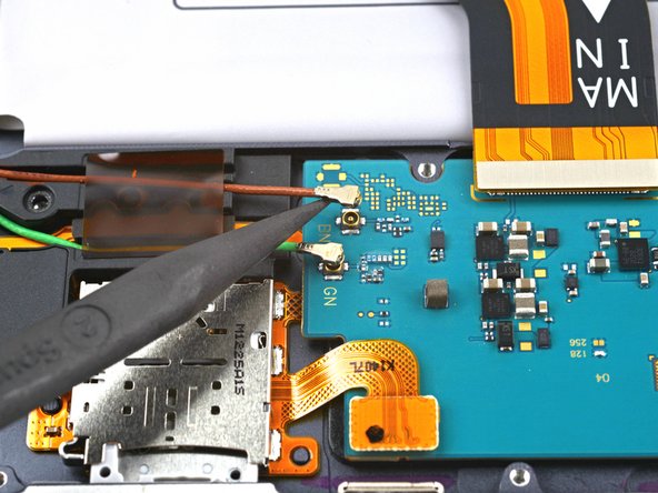

  28. Samsung Galaxy Tab S7 Plus Loudspeaker Assembly Replacement, Disconnect the 5G antenna: crwdns2935265:028crwdnd2935265:01crwdnd2935265:02crwdne2935265:0 Samsung Galaxy Tab S7 Plus Loudspeaker Assembly Replacement, Disconnect the 5G antenna: crwdns2935265:028crwdnd2935265:02crwdnd2935265:02crwdne2935265:0
    • Use the flat end of a spudger to pry up and disconnect the 5G antenna's press connector secured to the motherboard.

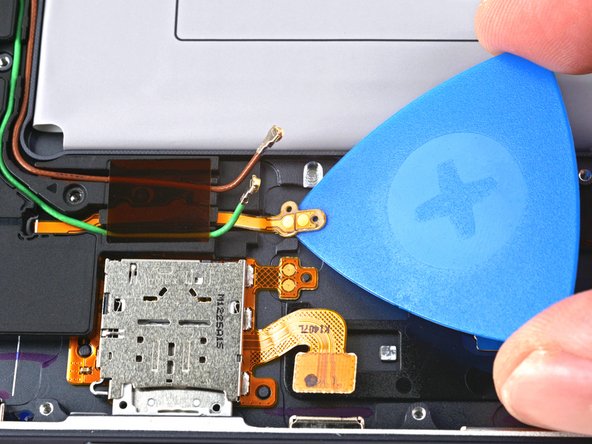

  29. Samsung Galaxy Tab S7 Plus Loudspeaker Assembly Replacement, Remove the 5G antenna: crwdns2935265:029crwdnd2935265:01crwdnd2935265:03crwdne2935265:0 Samsung Galaxy Tab S7 Plus Loudspeaker Assembly Replacement, Remove the 5G antenna: crwdns2935265:029crwdnd2935265:02crwdnd2935265:03crwdne2935265:0 Samsung Galaxy Tab S7 Plus Loudspeaker Assembly Replacement, Remove the 5G antenna: crwdns2935265:029crwdnd2935265:03crwdnd2935265:03crwdne2935265:0
    • Use tweezers to pull the antenna out of the frame by its bracket.
    • Remove the 5G antenna.

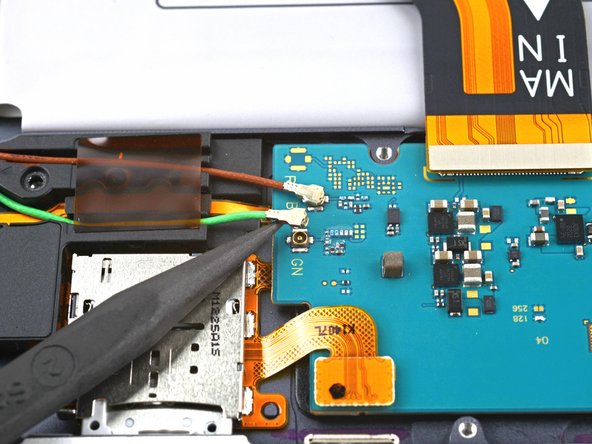

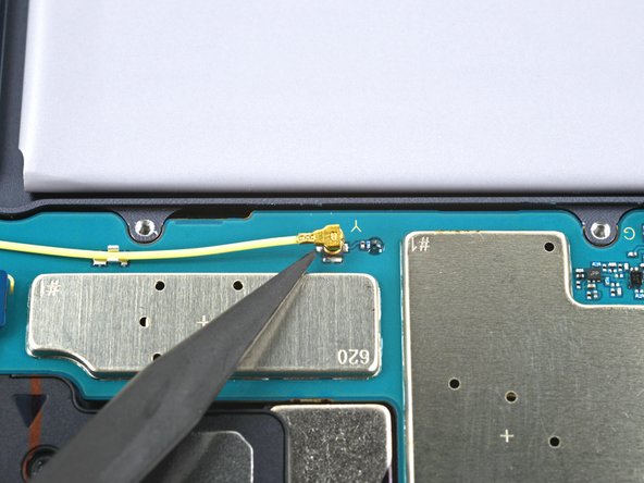

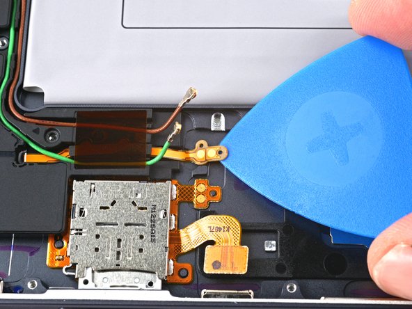

  30. Samsung Galaxy Tab S7 Plus Loudspeaker Assembly Replacement, Disconnect the left coaxial cables: crwdns2935265:030crwdnd2935265:01crwdnd2935265:03crwdne2935265:0 Samsung Galaxy Tab S7 Plus Loudspeaker Assembly Replacement, Disconnect the left coaxial cables: crwdns2935265:030crwdnd2935265:02crwdnd2935265:03crwdne2935265:0 Samsung Galaxy Tab S7 Plus Loudspeaker Assembly Replacement, Disconnect the left coaxial cables: crwdns2935265:030crwdnd2935265:03crwdnd2935265:03crwdne2935265:0
    • Use the point of a spudger to carefully pry up and disconnect the green coaxial cable from the left side of the motherboard.
    • Repeat this process for the red coaxial cable.

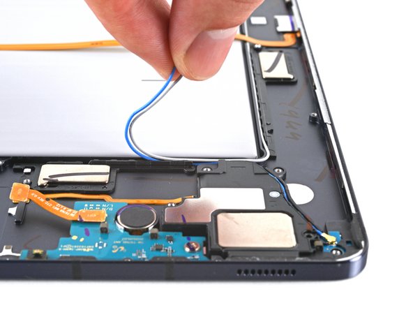

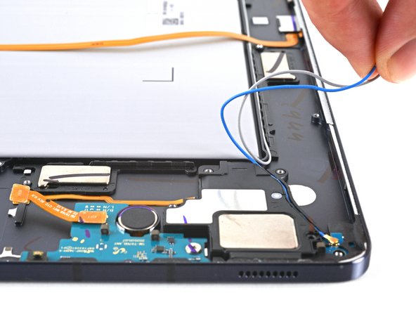

  34. Samsung Galaxy Tab S7 Plus Loudspeaker Assembly Replacement, Reposition the bottom-right coaxial cable: crwdns2935265:034crwdnd2935265:01crwdnd2935265:02crwdne2935265:0 Samsung Galaxy Tab S7 Plus Loudspeaker Assembly Replacement, Reposition the bottom-right coaxial cable: crwdns2935265:034crwdnd2935265:02crwdnd2935265:02crwdne2935265:0
    • Pull the coaxial cable away from the frame, making sure the cable is completely unthreaded from the motherboard.

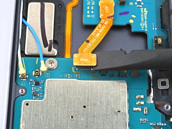

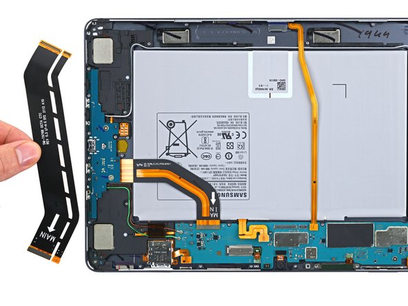

  35. Samsung Galaxy Tab S7 Plus Loudspeaker Assembly Replacement, Disconnect the interconnect cable: crwdns2935265:035crwdnd2935265:01crwdnd2935265:02crwdne2935265:0 Samsung Galaxy Tab S7 Plus Loudspeaker Assembly Replacement, Disconnect the interconnect cable: crwdns2935265:035crwdnd2935265:02crwdnd2935265:02crwdne2935265:0
    • Use the flat end of a spudger to pry up and disconnect the interconnect cable's press connector secured to the motherboard.

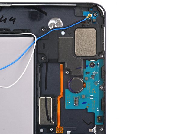

  36. Samsung Galaxy Tab S7 Plus Loudspeaker Assembly Replacement, Disconnect the top-right coaxial cables: crwdns2935265:036crwdnd2935265:01crwdnd2935265:03crwdne2935265:0 Samsung Galaxy Tab S7 Plus Loudspeaker Assembly Replacement, Disconnect the top-right coaxial cables: crwdns2935265:036crwdnd2935265:02crwdnd2935265:03crwdne2935265:0 Samsung Galaxy Tab S7 Plus Loudspeaker Assembly Replacement, Disconnect the top-right coaxial cables: crwdns2935265:036crwdnd2935265:03crwdnd2935265:03crwdne2935265:0
    • Use the point of a spudger to carefully pry up and disconnect the top-right loudspeaker's blue coaxial cable from the motherboard.
    • Repeat this process for the white coaxial cable.

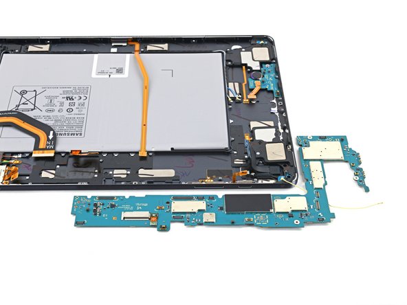

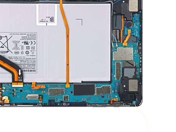

  37. Samsung Galaxy Tab S7 Plus Loudspeaker Assembly Replacement, Unfasten the motherboard: crwdns2935265:037crwdnd2935265:01crwdnd2935265:02crwdne2935265:0 Samsung Galaxy Tab S7 Plus Loudspeaker Assembly Replacement, Unfasten the motherboard: crwdns2935265:037crwdnd2935265:02crwdnd2935265:02crwdne2935265:0
    • Use a Phillips #00 screwdriver to remove the three 2 mm screws securing the motherboard to the frame.

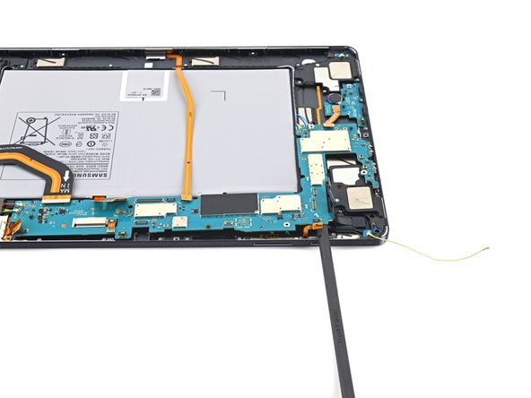

  38. Samsung Galaxy Tab S7 Plus Loudspeaker Assembly Replacement, Remove the motherboard: crwdns2935265:038crwdnd2935265:01crwdnd2935265:03crwdne2935265:0 Samsung Galaxy Tab S7 Plus Loudspeaker Assembly Replacement, Remove the motherboard: crwdns2935265:038crwdnd2935265:02crwdnd2935265:03crwdne2935265:0 Samsung Galaxy Tab S7 Plus Loudspeaker Assembly Replacement, Remove the motherboard: crwdns2935265:038crwdnd2935265:03crwdnd2935265:03crwdne2935265:0
    • Insert a spudger into a gap between the motherboard and the frame.
    • Pry up with the spudger to release the motherboard from its clips.
    • Remove the motherboard.
    • During reassembly, refasten the motherboard screws first to properly align it into place, then reconnect the cables.

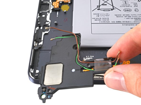

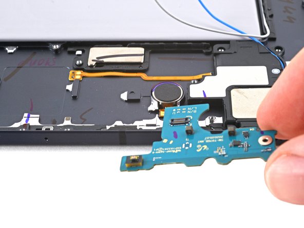

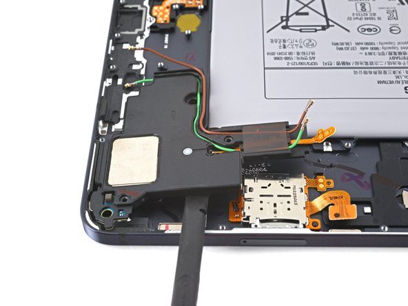

  39. Samsung Galaxy Tab S7 Plus Loudspeaker Assembly Replacement, Speaker assembly information: crwdns2935265:039crwdnd2935265:01crwdnd2935265:02crwdne2935265:0 Samsung Galaxy Tab S7 Plus Loudspeaker Assembly Replacement, Speaker assembly information: crwdns2935265:039crwdnd2935265:02crwdnd2935265:02crwdne2935265:0
  40. Samsung Galaxy Tab S7 Plus Loudspeaker Assembly Replacement, Reposition the bottom-left coaxial cable: crwdns2935265:040crwdnd2935265:01crwdnd2935265:03crwdne2935265:0 Samsung Galaxy Tab S7 Plus Loudspeaker Assembly Replacement, Reposition the bottom-left coaxial cable: crwdns2935265:040crwdnd2935265:02crwdnd2935265:03crwdne2935265:0 Samsung Galaxy Tab S7 Plus Loudspeaker Assembly Replacement, Reposition the bottom-left coaxial cable: crwdns2935265:040crwdnd2935265:03crwdnd2935265:03crwdne2935265:0
    • Pull the bottom-left coaxial cables away from the frame, making sure the cables are completely unthreaded from the frame.

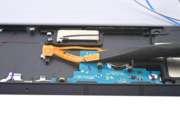

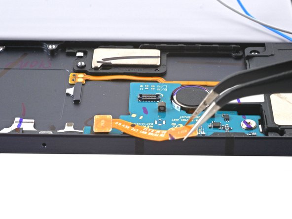

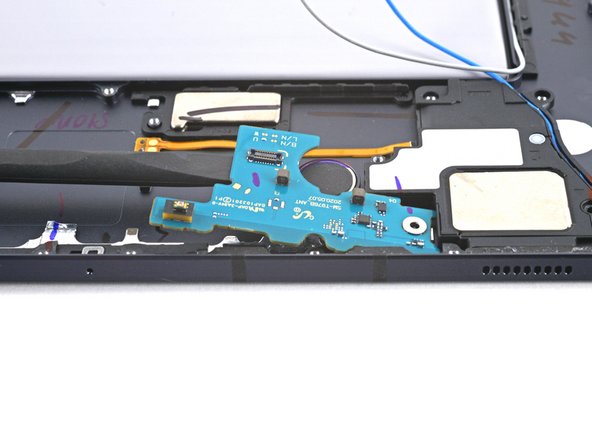

  41. Samsung Galaxy Tab S7 Plus Loudspeaker Assembly Replacement, Remove the antenna board's interconnect cable: crwdns2935265:041crwdnd2935265:01crwdnd2935265:03crwdne2935265:0 Samsung Galaxy Tab S7 Plus Loudspeaker Assembly Replacement, Remove the antenna board's interconnect cable: crwdns2935265:041crwdnd2935265:02crwdnd2935265:03crwdne2935265:0 Samsung Galaxy Tab S7 Plus Loudspeaker Assembly Replacement, Remove the antenna board's interconnect cable: crwdns2935265:041crwdnd2935265:03crwdnd2935265:03crwdne2935265:0
    • Use the flat end of a spudger to pry up and disconnect the antenna board's interconnect cable secured to the antenna board.
    • Use tweezers, or your fingers, to remove the cable.
  42. Samsung Galaxy Tab S7 Plus Loudspeaker Assembly Replacement, Unfasten the antenna board: crwdns2935265:042crwdnd2935265:01crwdnd2935265:02crwdne2935265:0 Samsung Galaxy Tab S7 Plus Loudspeaker Assembly Replacement, Unfasten the antenna board: crwdns2935265:042crwdnd2935265:02crwdnd2935265:02crwdne2935265:0
    • Use a Phillips #00 screwdriver to remove the 2 mm screw securing the antenna board to the frame.
  43. Samsung Galaxy Tab S7 Plus Loudspeaker Assembly Replacement, Remove the antenna board: crwdns2935265:043crwdnd2935265:01crwdnd2935265:03crwdne2935265:0 Samsung Galaxy Tab S7 Plus Loudspeaker Assembly Replacement, Remove the antenna board: crwdns2935265:043crwdnd2935265:02crwdnd2935265:03crwdne2935265:0 Samsung Galaxy Tab S7 Plus Loudspeaker Assembly Replacement, Remove the antenna board: crwdns2935265:043crwdnd2935265:03crwdnd2935265:03crwdne2935265:0
    • Insert a spudger into a gap between the antenna board and the frame.
    • Pry up with the spudger to separate the antenna board from the frame.
    • Remove the antenna board.
  44. Samsung Galaxy Tab S7 Plus Loudspeaker Assembly Replacement, Heat the left edge: crwdns2935265:044crwdnd2935265:01crwdnd2935265:01crwdne2935265:0
    • The bottom-left loudspeaker's connector is secured to the frame by adhesive; use heat to avoid tearing the connector.
    • Apply a heated iOpener to the left edge of the device for two minutes.
    • A hair dryer, heat gun, or hot plate may also be used, but be careful not to overheat the device.
  45. Samsung Galaxy Tab S7 Plus Loudspeaker Assembly Replacement, Separate the connector's adhesive: crwdns2935265:045crwdnd2935265:01crwdnd2935265:02crwdne2935265:0 Samsung Galaxy Tab S7 Plus Loudspeaker Assembly Replacement, Separate the connector's adhesive: crwdns2935265:045crwdnd2935265:02crwdnd2935265:02crwdne2935265:0
    • Insert an opening pick between the bottom-left loudspeaker's copper connector pads and the frame.
    • Pry up while slicing the adhesive to separate the pad from the frame.
  46. Samsung Galaxy Tab S7 Plus Loudspeaker Assembly Replacement: crwdns2935265:046crwdnd2935265:01crwdnd2935265:03crwdne2935265:0 Samsung Galaxy Tab S7 Plus Loudspeaker Assembly Replacement: crwdns2935265:046crwdnd2935265:02crwdnd2935265:03crwdne2935265:0 Samsung Galaxy Tab S7 Plus Loudspeaker Assembly Replacement: crwdns2935265:046crwdnd2935265:03crwdnd2935265:03crwdne2935265:0
    • Slice with the opening pick along the bottom of the connector's cable to completely separate it from the frame.
  47. Samsung Galaxy Tab S7 Plus Loudspeaker Assembly Replacement, Remove the loudspeaker: crwdns2935265:047crwdnd2935265:01crwdnd2935265:03crwdne2935265:0 Samsung Galaxy Tab S7 Plus Loudspeaker Assembly Replacement, Remove the loudspeaker: crwdns2935265:047crwdnd2935265:02crwdnd2935265:03crwdne2935265:0 Samsung Galaxy Tab S7 Plus Loudspeaker Assembly Replacement, Remove the loudspeaker: crwdns2935265:047crwdnd2935265:03crwdnd2935265:03crwdne2935265:0
    • Use a spudger to pry up and separate the loudspeaker from the frame.
    • Remove the loudspeaker.

  51. Samsung Galaxy Tab S7 Plus Loudspeaker Assembly Replacement, Unfasten the charging daughterboard: crwdns2935265:051crwdnd2935265:01crwdnd2935265:02crwdne2935265:0 Samsung Galaxy Tab S7 Plus Loudspeaker Assembly Replacement, Unfasten the charging daughterboard: crwdns2935265:051crwdnd2935265:02crwdnd2935265:02crwdne2935265:0
    • Use a Phillips #00 screwdriver to remove the two 2 mm screws securing the charging daughterboard to the frame.
  52. Samsung Galaxy Tab S7 Plus Loudspeaker Assembly Replacement, Reposition the charging daughterboard: crwdns2935265:052crwdnd2935265:01crwdnd2935265:02crwdne2935265:0 Samsung Galaxy Tab S7 Plus Loudspeaker Assembly Replacement, Reposition the charging daughterboard: crwdns2935265:052crwdnd2935265:02crwdnd2935265:02crwdne2935265:0
    • Insert a spudger between the charging daughterboard and the frame.
    • Pry up with the spudger to release the clips securing the charging daughterboard.
  53. Samsung Galaxy Tab S7 Plus Loudspeaker Assembly Replacement: crwdns2935265:053crwdnd2935265:01crwdnd2935265:03crwdne2935265:0 Samsung Galaxy Tab S7 Plus Loudspeaker Assembly Replacement: crwdns2935265:053crwdnd2935265:02crwdnd2935265:03crwdne2935265:0 Samsung Galaxy Tab S7 Plus Loudspeaker Assembly Replacement: crwdns2935265:053crwdnd2935265:03crwdnd2935265:03crwdne2935265:0
    • Use your fingers to pull the charging daughterboard from its slot in the frame.
    • Turn the charging board upside down, making sure not to twist the coaxial cables too far.
  54. Samsung Galaxy Tab S7 Plus Loudspeaker Assembly Replacement, Disconnect the interconnect cable: crwdns2935265:054crwdnd2935265:01crwdnd2935265:02crwdne2935265:0 Samsung Galaxy Tab S7 Plus Loudspeaker Assembly Replacement, Disconnect the interconnect cable: crwdns2935265:054crwdnd2935265:02crwdnd2935265:02crwdne2935265:0
    • Use the flat end of a spudger to pry up and disconnect the interconnect cable's press connector secured to the charging daughterboard.
    • Use tweezers, or your fingers, to remove the interconnect cable.
  55. Samsung Galaxy Tab S7 Plus Loudspeaker Assembly Replacement, Disconnect the coaxial cables: crwdns2935265:055crwdnd2935265:01crwdnd2935265:03crwdne2935265:0 Samsung Galaxy Tab S7 Plus Loudspeaker Assembly Replacement, Disconnect the coaxial cables: crwdns2935265:055crwdnd2935265:02crwdnd2935265:03crwdne2935265:0 Samsung Galaxy Tab S7 Plus Loudspeaker Assembly Replacement, Disconnect the coaxial cables: crwdns2935265:055crwdnd2935265:03crwdnd2935265:03crwdne2935265:0
    • Use the point of a spudger to carefully pry up and disconnect the red and green coaxial cable from the bottom of the daughterboard.
    • During reassembly, these can be tricky to reconnect. One at a time, hold each connector in place over its socket and press down with the flat end of a spudger. The connector should snap into place.
  56. Samsung Galaxy Tab S7 Plus Loudspeaker Assembly Replacement: crwdns2935265:056crwdnd2935265:01crwdnd2935265:02crwdne2935265:0 Samsung Galaxy Tab S7 Plus Loudspeaker Assembly Replacement: crwdns2935265:056crwdnd2935265:02crwdnd2935265:02crwdne2935265:0
    • Use the point of a spudger to carefully pry up and disconnect the white coaxial cable from the top of the daughterboard.
  57. Samsung Galaxy Tab S7 Plus Loudspeaker Assembly Replacement, Remove the charging daughterboard: crwdns2935265:057crwdnd2935265:01crwdnd2935265:02crwdne2935265:0 Samsung Galaxy Tab S7 Plus Loudspeaker Assembly Replacement, Remove the charging daughterboard: crwdns2935265:057crwdnd2935265:02crwdnd2935265:02crwdne2935265:0
    • Remove the daughterboard from the frame.
    • During reassembly, refasten the charging daughterboard screws first to properly align it into place, then reconnect the interconnect cable.

  59. Samsung Galaxy Tab S7 Plus Loudspeaker Assembly Replacement, Separate loudspeaker cable's adhesive: crwdns2935265:059crwdnd2935265:01crwdnd2935265:03crwdne2935265:0 Samsung Galaxy Tab S7 Plus Loudspeaker Assembly Replacement, Separate loudspeaker cable's adhesive: crwdns2935265:059crwdnd2935265:02crwdnd2935265:03crwdne2935265:0 Samsung Galaxy Tab S7 Plus Loudspeaker Assembly Replacement, Separate loudspeaker cable's adhesive: crwdns2935265:059crwdnd2935265:03crwdnd2935265:03crwdne2935265:0
    • Insert an opening pick between the loudspeaker's copper connector pads and the frame.
    • Slice the adhesive while prying up with the pick to separate the pads from the frame.
