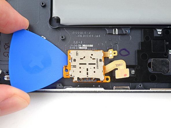

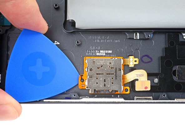

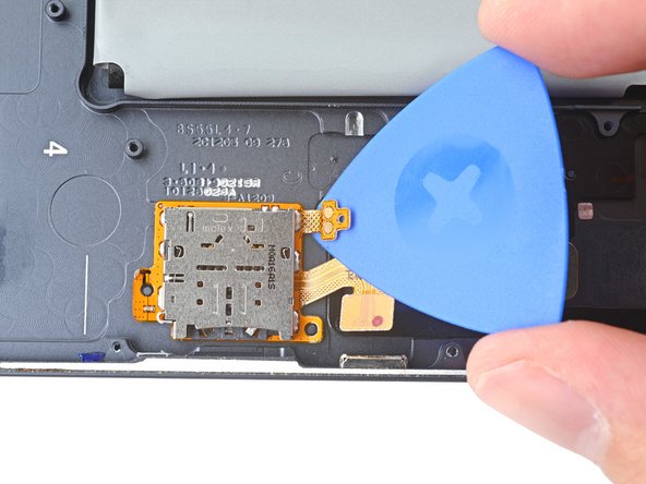

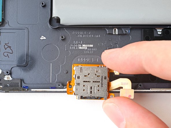

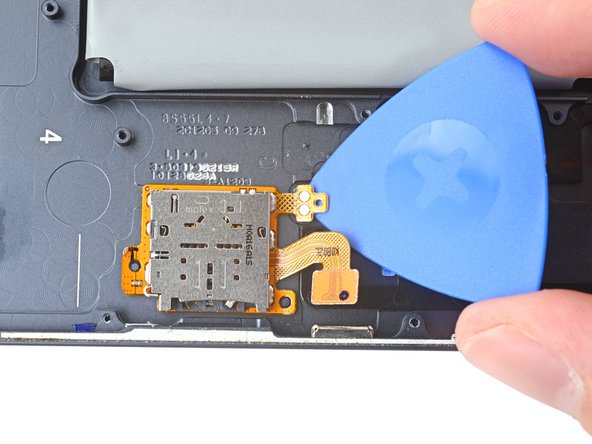

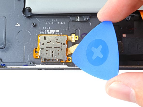

  28. Samsung Galaxy Tab S7 Plus 5G microSD Card Reader Replacement, Disconnect the microSD card reader: crwdns2935265:028crwdnd2935265:01crwdnd2935265:02crwdne2935265:0 Samsung Galaxy Tab S7 Plus 5G microSD Card Reader Replacement, Disconnect the microSD card reader: crwdns2935265:028crwdnd2935265:02crwdnd2935265:02crwdne2935265:0
    • Use the flat end of a spudger to pry up and disconnect the microSD card reader's press connector secured to the motherboard.

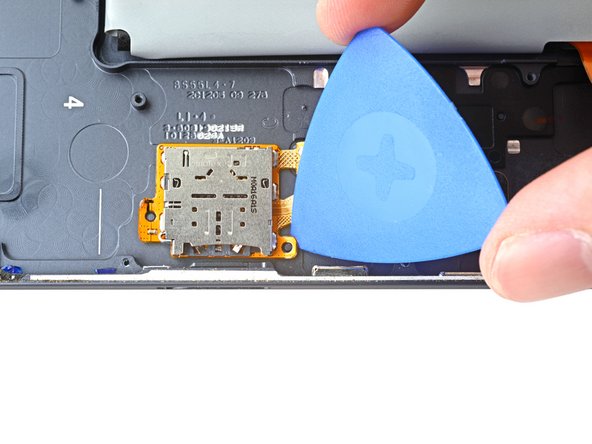

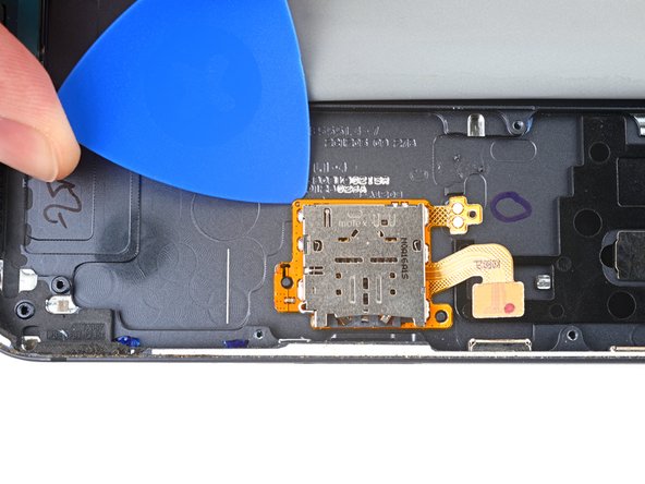

  40. Samsung Galaxy Tab S7 Plus 5G microSD Card Reader Replacement, Heat the right edge: crwdns2935265:040crwdnd2935265:01crwdnd2935265:01crwdne2935265:0
    • The top-right loudspeaker's connector is secured to the frame by adhesive; use heat to avoid tearing the connector.
    • Apply a heated iOpener to the left edge of the device for two minutes.

  43. Samsung Galaxy Tab S7 Plus 5G microSD Card Reader Replacement, Heat the bottom edge: crwdns2935265:043crwdnd2935265:01crwdnd2935265:01crwdne2935265:0
    • The microSD card reader is secured to the frame by adhesive; use heat to avoid tearing the connectors.
    • Apply a heated iOpener to the bottom edge of the device for two minutes.
    • A hair dryer, heat gun, or hot plate may also be used, but be careful not to overheat the device.
  44. Samsung Galaxy Tab S7 Plus 5G microSD Card Reader Replacement, Separate the microSD card reader's adhesive: crwdns2935265:044crwdnd2935265:01crwdnd2935265:03crwdne2935265:0 Samsung Galaxy Tab S7 Plus 5G microSD Card Reader Replacement, Separate the microSD card reader's adhesive: crwdns2935265:044crwdnd2935265:02crwdnd2935265:03crwdne2935265:0 Samsung Galaxy Tab S7 Plus 5G microSD Card Reader Replacement, Separate the microSD card reader's adhesive: crwdns2935265:044crwdnd2935265:03crwdnd2935265:03crwdne2935265:0
    • Insert a pick between the top-right copper connector pads and the frame.
    • Pry up while slicing the adhesive to separate the pads from the frame.
  45. Samsung Galaxy Tab S7 Plus 5G microSD Card Reader Replacement: crwdns2935265:045crwdnd2935265:01crwdnd2935265:03crwdne2935265:0 Samsung Galaxy Tab S7 Plus 5G microSD Card Reader Replacement: crwdns2935265:045crwdnd2935265:02crwdnd2935265:03crwdne2935265:0 Samsung Galaxy Tab S7 Plus 5G microSD Card Reader Replacement: crwdns2935265:045crwdnd2935265:03crwdnd2935265:03crwdne2935265:0
    • Insert a pick between the bottom-right peg hole and the frame.
    • Rotate the pick along the peg hole's perimeter to separate it from the frame.
  46. Samsung Galaxy Tab S7 Plus 5G microSD Card Reader Replacement: crwdns2935265:046crwdnd2935265:01crwdnd2935265:03crwdne2935265:0 Samsung Galaxy Tab S7 Plus 5G microSD Card Reader Replacement: crwdns2935265:046crwdnd2935265:02crwdnd2935265:03crwdne2935265:0 Samsung Galaxy Tab S7 Plus 5G microSD Card Reader Replacement: crwdns2935265:046crwdnd2935265:03crwdnd2935265:03crwdne2935265:0
    • Insert a pick between the top of the microSD card reader and the frame.
    • Rotate the pick around the perimeter of the microSD reader to slice the adhesive.
  47. Samsung Galaxy Tab S7 Plus 5G microSD Card Reader Replacement, Remove the microSD card reader: crwdns2935265:047crwdnd2935265:01crwdnd2935265:03crwdne2935265:0 Samsung Galaxy Tab S7 Plus 5G microSD Card Reader Replacement, Remove the microSD card reader: crwdns2935265:047crwdnd2935265:02crwdnd2935265:03crwdne2935265:0 Samsung Galaxy Tab S7 Plus 5G microSD Card Reader Replacement, Remove the microSD card reader: crwdns2935265:047crwdnd2935265:03crwdnd2935265:03crwdne2935265:0
    • At this point, the perimeter of the microSD card reader should be separated from the frame. If there's still resistance around the edges of the screen, use an opening pick to cut the adhesive again.
    • Insert an opening pick between the bottom-left peg hole and the frame.
    • Pry up with the pick to separate the microSD card reader from the frame.
    • Remove the microSD card reader.
