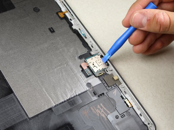

  13. Samsung Galaxy Tab S2 9.7 SM-T813 SD Card Reader Replacement: crwdns2935265:013crwdnd2935265:01crwdnd2935265:03crwdne2935265:0 Samsung Galaxy Tab S2 9.7 SM-T813 SD Card Reader Replacement: crwdns2935265:013crwdnd2935265:02crwdnd2935265:03crwdne2935265:0 Samsung Galaxy Tab S2 9.7 SM-T813 SD Card Reader Replacement: crwdns2935265:013crwdnd2935265:03crwdnd2935265:03crwdne2935265:0
    • Use the plastic opening tool to unlock the SD card reader from the back panel.
    • Wedge the tool under the reader and gently lift up to pop it out.

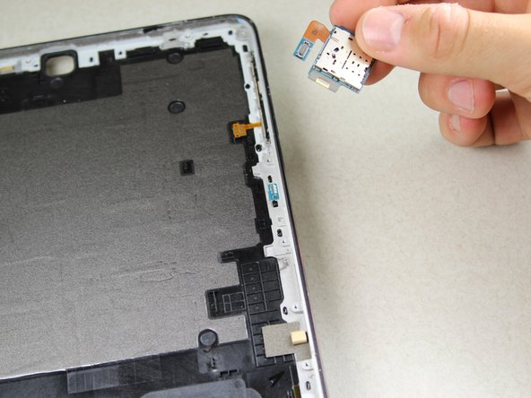

  14. Samsung Galaxy Tab S2 9.7 SM-T813 SD Card Reader Replacement: crwdns2935265:014crwdnd2935265:01crwdnd2935265:02crwdne2935265:0 Samsung Galaxy Tab S2 9.7 SM-T813 SD Card Reader Replacement: crwdns2935265:014crwdnd2935265:02crwdnd2935265:02crwdne2935265:0
    • Pick up the SD card reader with your fingers. There is no adhesive, so the reader will come off easily.
