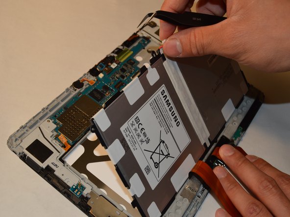

    • Use a plastic tweezer and remove the top center 6 pin power connector that is attached to the edge of the motherboard.
    • Detach the battery by gently lifting the battery out of the panel.

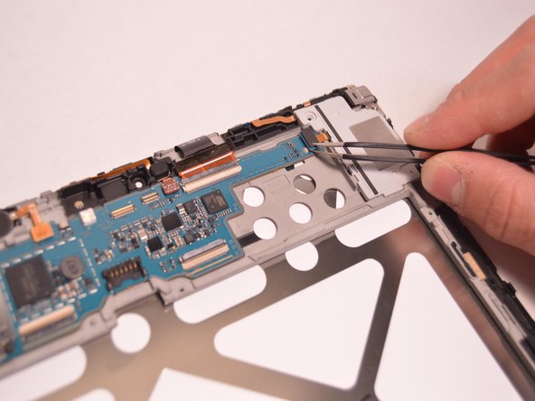

  5. Samsung Galaxy Tab Pro 10.1 Motherboard Replacement, Front Facing Camera: crwdns2935265:05crwdnd2935265:01crwdnd2935265:03crwdne2935265:0 Samsung Galaxy Tab Pro 10.1 Motherboard Replacement, Front Facing Camera: crwdns2935265:05crwdnd2935265:02crwdnd2935265:03crwdne2935265:0 Samsung Galaxy Tab Pro 10.1 Motherboard Replacement, Front Facing Camera: crwdns2935265:05crwdnd2935265:03crwdnd2935265:03crwdne2935265:0
    • Use plastic tweezers to carefully detach the front-facing camera from the motherboard.
  6. Samsung Galaxy Tab Pro 10.1 Motherboard Replacement, Rear Facing Camera: crwdns2935265:06crwdnd2935265:01crwdnd2935265:03crwdne2935265:0 Samsung Galaxy Tab Pro 10.1 Motherboard Replacement, Rear Facing Camera: crwdns2935265:06crwdnd2935265:02crwdnd2935265:03crwdne2935265:0 Samsung Galaxy Tab Pro 10.1 Motherboard Replacement, Rear Facing Camera: crwdns2935265:06crwdnd2935265:03crwdnd2935265:03crwdne2935265:0
    • Use plastic tweezers and carefully detach the rear-facing camera from the motherboard.

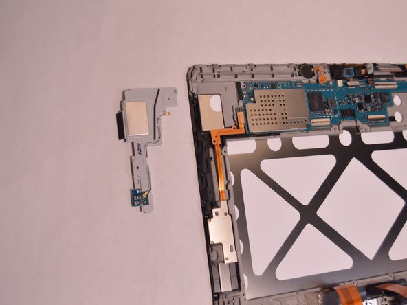

  7. Samsung Galaxy Tab Pro 10.1 Motherboard Replacement, Motherboard: crwdns2935265:07crwdnd2935265:01crwdnd2935265:02crwdne2935265:0 Samsung Galaxy Tab Pro 10.1 Motherboard Replacement, Motherboard: crwdns2935265:07crwdnd2935265:02crwdnd2935265:02crwdne2935265:0
    • Remove the five ribbon cables holding the motherboard together with a plastic tweezer.
  8. Samsung Galaxy Tab Pro 10.1 Motherboard Replacement: crwdns2935265:08crwdnd2935265:01crwdnd2935265:02crwdne2935265:0 Samsung Galaxy Tab Pro 10.1 Motherboard Replacement: crwdns2935265:08crwdnd2935265:02crwdnd2935265:02crwdne2935265:0
    • Remove the Phillips #00 screws from the plastic part holding down the motherboard.
  9. Samsung Galaxy Tab Pro 10.1 Motherboard Replacement: crwdns2935265:09crwdnd2935265:01crwdnd2935265:01crwdne2935265:0
    • Gently lift the motherboard from the front panel enclosure.
