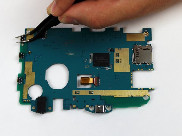

  9. Samsung Galaxy Tab E Lite 7 Kids Volume Button Replacement, Volume Button: crwdns2935265:09crwdnd2935265:01crwdnd2935265:02crwdne2935265:0 Samsung Galaxy Tab E Lite 7 Kids Volume Button Replacement, Volume Button: crwdns2935265:09crwdnd2935265:02crwdnd2935265:02crwdne2935265:0
    • Use a soldering iron to heat 4 spots of solder from the motherboard.
    • To learn more about soldering, check out iFixit's soldering technique guide.
    • Use precision tweezers to remove the volume buttons.
