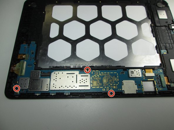

  6. Samsung Galaxy Tab A 9.7 Motherboard Replacement, Motherboard: crwdns2935265:06crwdnd2935265:01crwdnd2935265:02crwdne2935265:0 Samsung Galaxy Tab A 9.7 Motherboard Replacement, Motherboard: crwdns2935265:06crwdnd2935265:02crwdnd2935265:02crwdne2935265:0
    • Use a #000 Philips screwdriver to remove the three 2.8mm screws attaching the motherboard to the device.

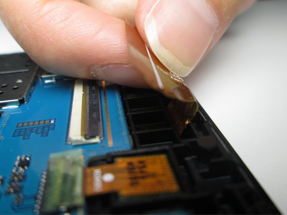

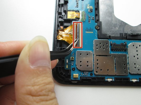

  8. Samsung Galaxy Tab A 9.7 Motherboard Replacement: crwdns2935265:08crwdnd2935265:01crwdnd2935265:03crwdne2935265:0 Samsung Galaxy Tab A 9.7 Motherboard Replacement: crwdns2935265:08crwdnd2935265:02crwdnd2935265:03crwdne2935265:0 Samsung Galaxy Tab A 9.7 Motherboard Replacement: crwdns2935265:08crwdnd2935265:03crwdnd2935265:03crwdne2935265:0
    • The digitizer is connected to the motherboard near the top of the device. It must be disconnected to remove the motherboard.
    • With your fingers, peel back the plastic sticker placed over the connector.
    • Using metal tweezers, gently flip the now-exposed black portion of the connector up.
    • Gently pull the copper-covered portion of the connector away from the motherboard.

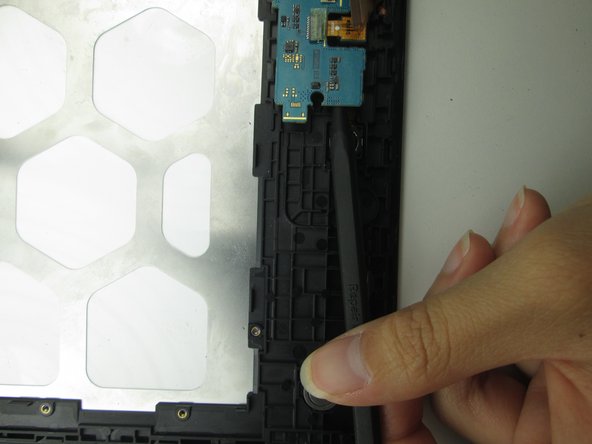

  9. Samsung Galaxy Tab A 9.7 Motherboard Replacement: crwdns2935265:09crwdnd2935265:01crwdnd2935265:03crwdne2935265:0 Samsung Galaxy Tab A 9.7 Motherboard Replacement: crwdns2935265:09crwdnd2935265:02crwdnd2935265:03crwdne2935265:0 Samsung Galaxy Tab A 9.7 Motherboard Replacement: crwdns2935265:09crwdnd2935265:03crwdnd2935265:03crwdne2935265:0
    • Using your fingers or a spudger, gently remove the motherboard from the device.
    • Keep in mind that both the front and back facing cameras are connected to the motherboard, so be careful when removing them.
