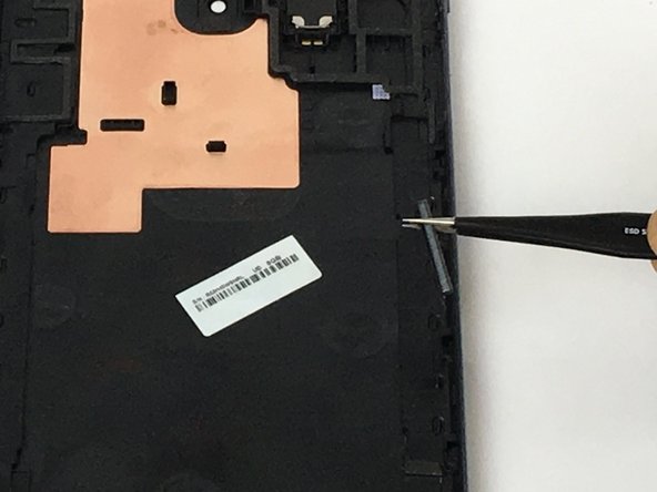

Samsung Galaxy Tab A 7.0 Volume Button Replacement
  1. Samsung Galaxy Tab A 7.0 Volume Button Replacement, Volume Button: crwdns2935265:01crwdnd2935265:01crwdnd2935265:01crwdne2935265:0
    • Using the plastic opening tool, starting at any corner on the tablet, insert the tool between the back panel and the front panel.
    • Slide tool around the tablet to unlock the panels from one another.
  2. Samsung Galaxy Tab A 7.0 Volume Button Replacement: crwdns2935265:02crwdnd2935265:01crwdnd2935265:02crwdne2935265:0 Samsung Galaxy Tab A 7.0 Volume Button Replacement: crwdns2935265:02crwdnd2935265:02crwdnd2935265:02crwdne2935265:0
    • Carefully remove the back panel from the front to expose the components inside the device.
    • The volume buttons are located on the back panel shown in the red box.
  3. Samsung Galaxy Tab A 7.0 Volume Button Replacement: crwdns2935265:03crwdnd2935265:01crwdnd2935265:02crwdne2935265:0 Samsung Galaxy Tab A 7.0 Volume Button Replacement: crwdns2935265:03crwdnd2935265:02crwdnd2935265:02crwdne2935265:0
    • Take your tweezers and gently push volume buttons loose from the panel.
